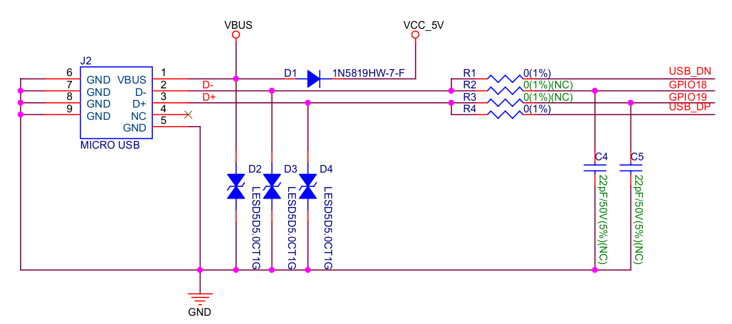

While looking at the schematic for the ESP32-C3-DevKitM-1, I noticed that the USB port on the board is not connected directly to the ESP32 module, but rather a CP2102N serial adapter.

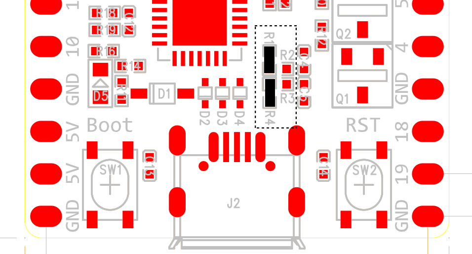

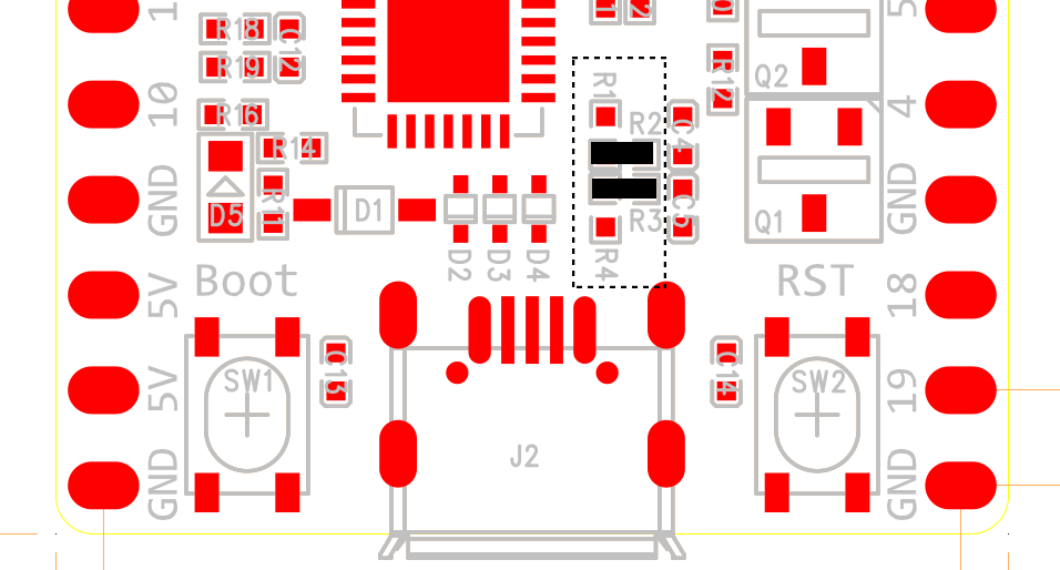

You should be able to use the JTAG function by removing the resistors R1 and R4 on the DevKitM-1 board and move them to the position for R2 and R3.
Serial Only configuration: USB JTAG configuration: You may also need to populate C4 and C5 for this to work.
I also checked to see if connecting another USB cable's GND, D-,D+ lines to the GND,18,19 pins of the devkit module and that seemed to work.
