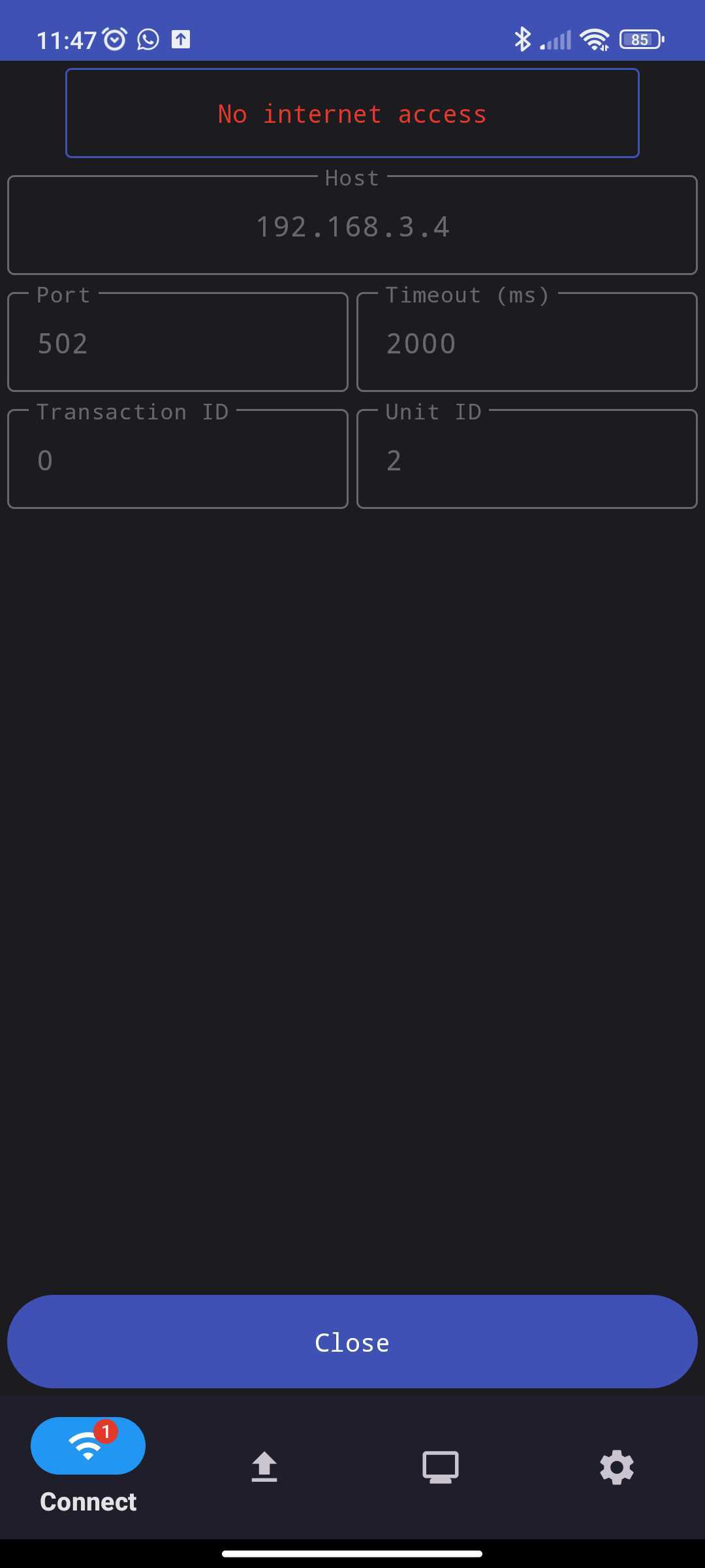

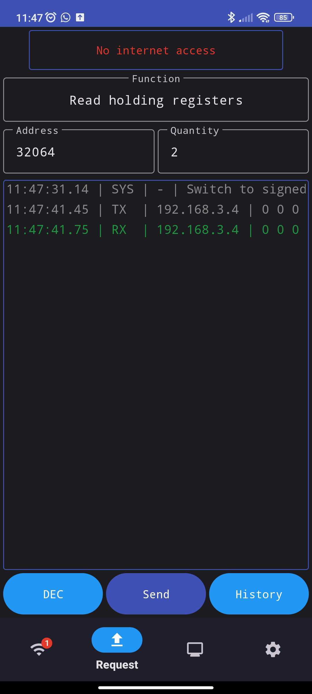

I started a new project with esp-idf v5.4 and esp-modbus v2.0.2. I am trying to create a tcp master and send commands to a unique slave device which has slave address 0x02.
I did the test before with a modbus client app and everything works OK, as you can see on the attached images. (IP: 192.168.3.4, Unit ID: 2, holding registers, register address: 32064, quantity: 2)
I have set on sdkconfig CONFIG_FMB_CONTROLLER_SLAVE_ID_SUPPORT=y and CONFIG_FMB_CONTROLLER_SLAVE_ID=0x2. Although I only have 1 slave, it has slave_address 0x02. In the mb_parameter_descriptor_t I have to set Modbus Slave Addr to 0x00 or set_descriptor fails. I attach the rest of the program but with everything like that the mbc_master_create_tcp and the mbc_master_start return OK but timeout on mbc_master_get_parameter.
