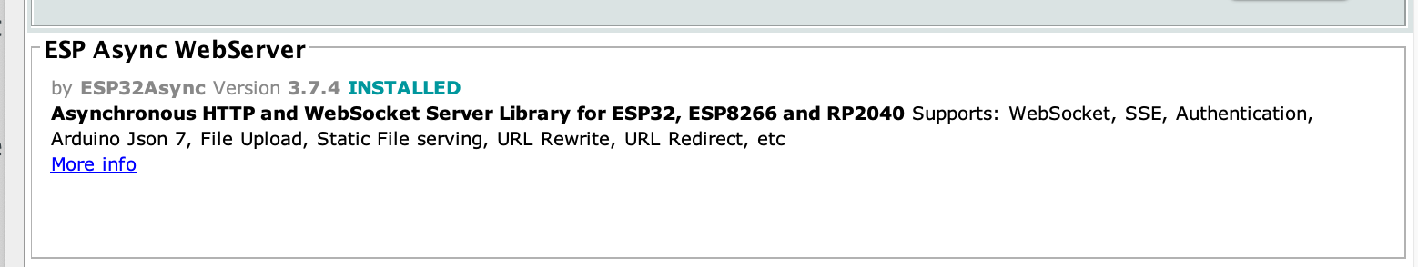

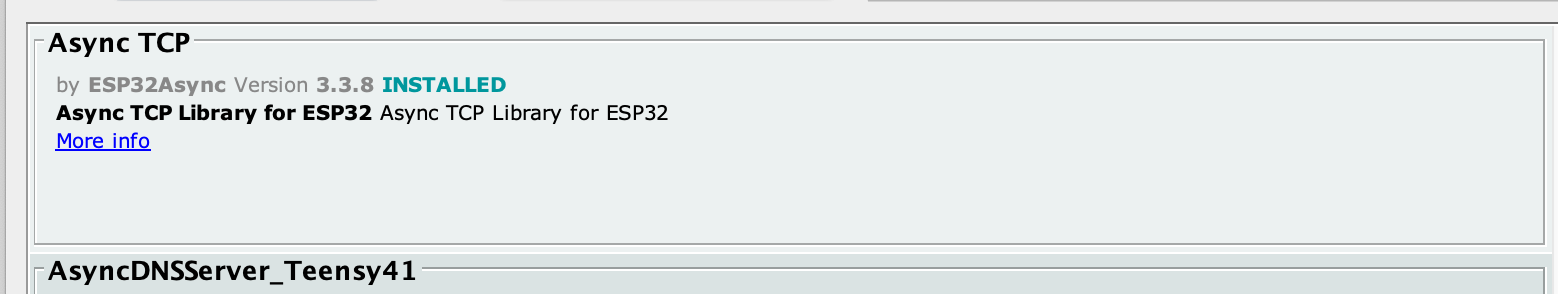

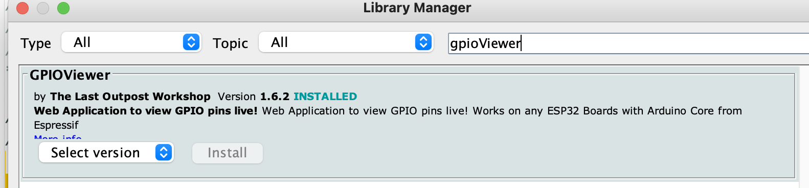

Phillip
Posts: 39
Joined: Thu Aug 25, 2022 11:57 pm
Re: gpio_viewer will not connect to wifi
Postby Phillip » Thu Apr 10, 2025 6:46 pm
Thank you for your help.
I think I have the latest working versions for all the components required as follows:
GPIOViewer
ESP Async WebServer
ESP Async WebServer.png (54.84 KiB) Viewed 340 times
AsyncTCP
The Espressif Systems version will follow.

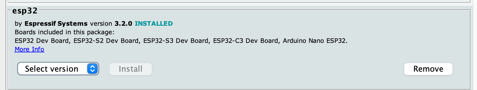

Phillip
Posts: 39
Postby Phillip » Thu Apr 10, 2025 6:48 pm
And lastly, here is my current version of Espressif Systems Core
Espressif Systems.png (51.86 KiB) Viewed 340 times
Thanks again for your help.

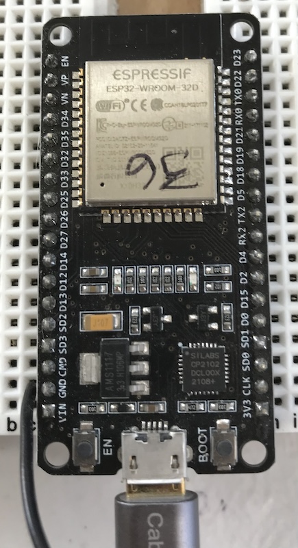

lbernstone
Posts: 1132
Postby lbernstone » Thu Apr 10, 2025 8:11 pm
What device?
Phillip
Posts: 39
Postby Phillip » Thu Apr 10, 2025 8:26 pm
I am using an ESP32-WROOM-32D (36-pins) as shown next:
Thanks.
