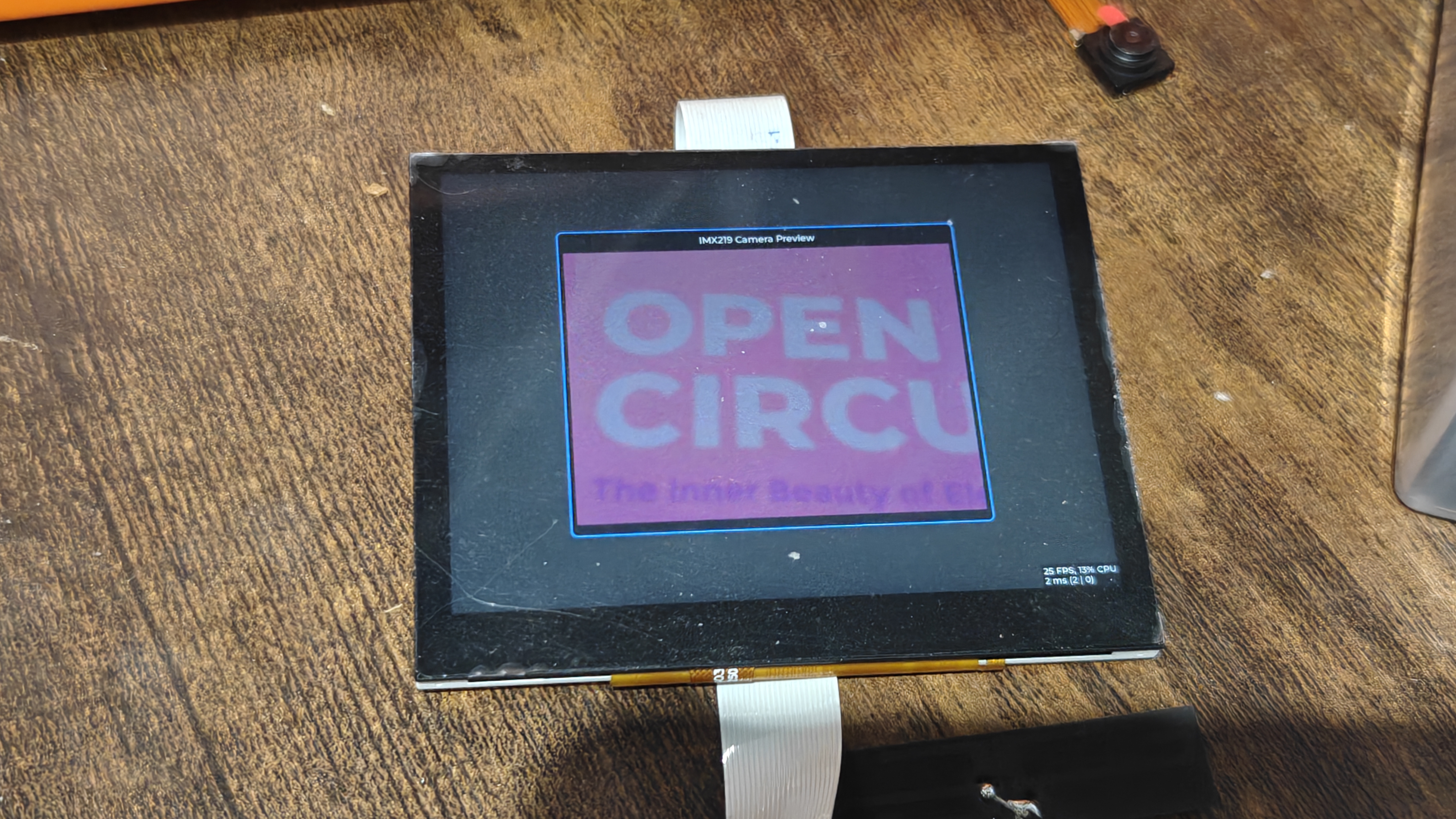

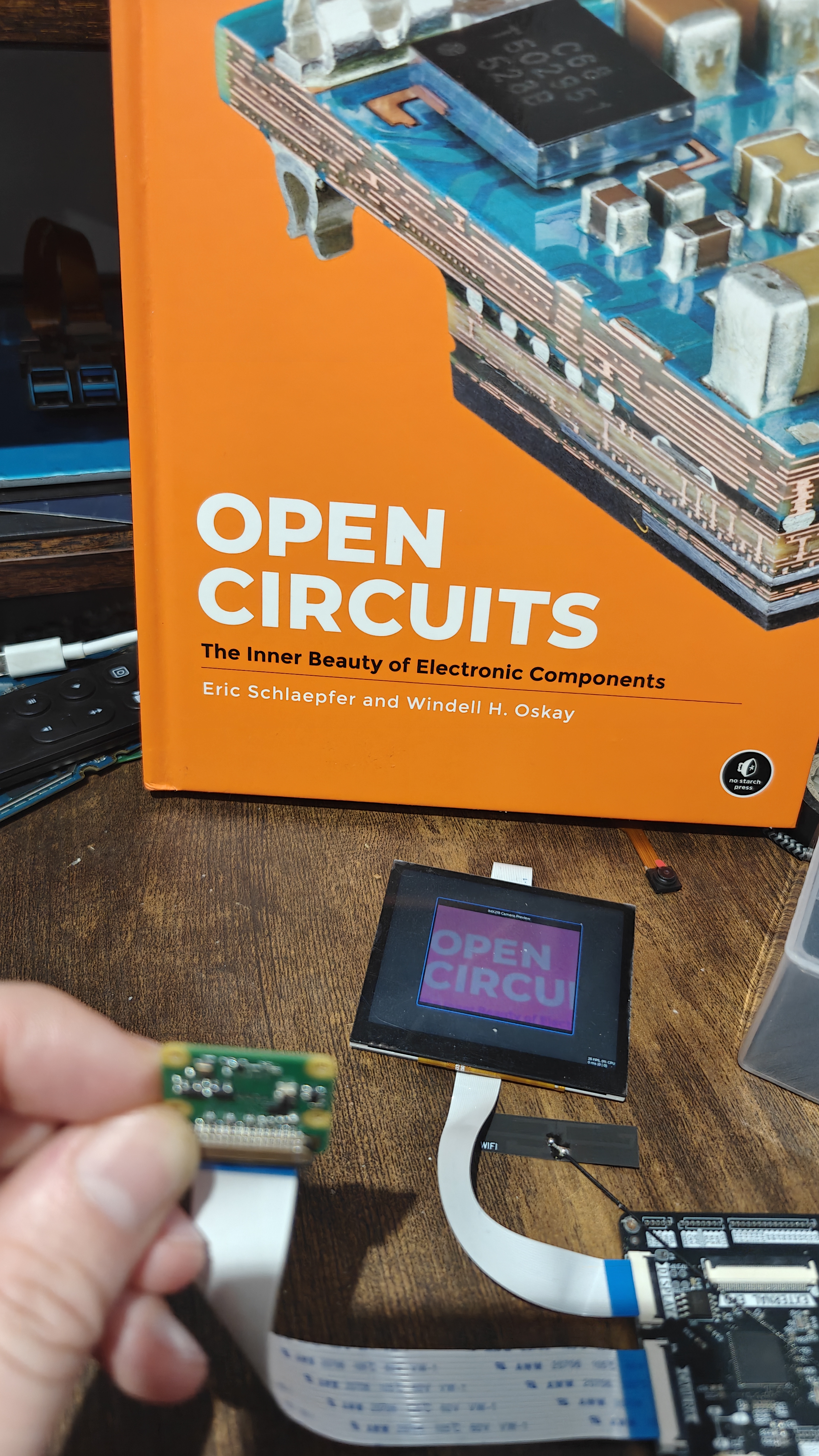

I have IMX219 working with ESP32-P4 (only 640x480 for now) but not sure how to configure ISP to have better picture
Here is what I currently have and working (check images)
If you wanna test (as I don't wanna push anything to git until is good enough for everyone) I'll upload just zip file here (esp_cam_sensor.zip)
To get it working on your board just use that as local component
  espressif/esp_cam_sensor:
    path: ../components/esp_cam_sensor
And you can use any examples to display camera buffer into display (or as I did via LVGL)
I can't post my whole project but if more people will get interested could migrate all to Github for easy use
So far would love for someone to help me with ISP and how to configure imx219_default.json
And also to get other resolutions work
