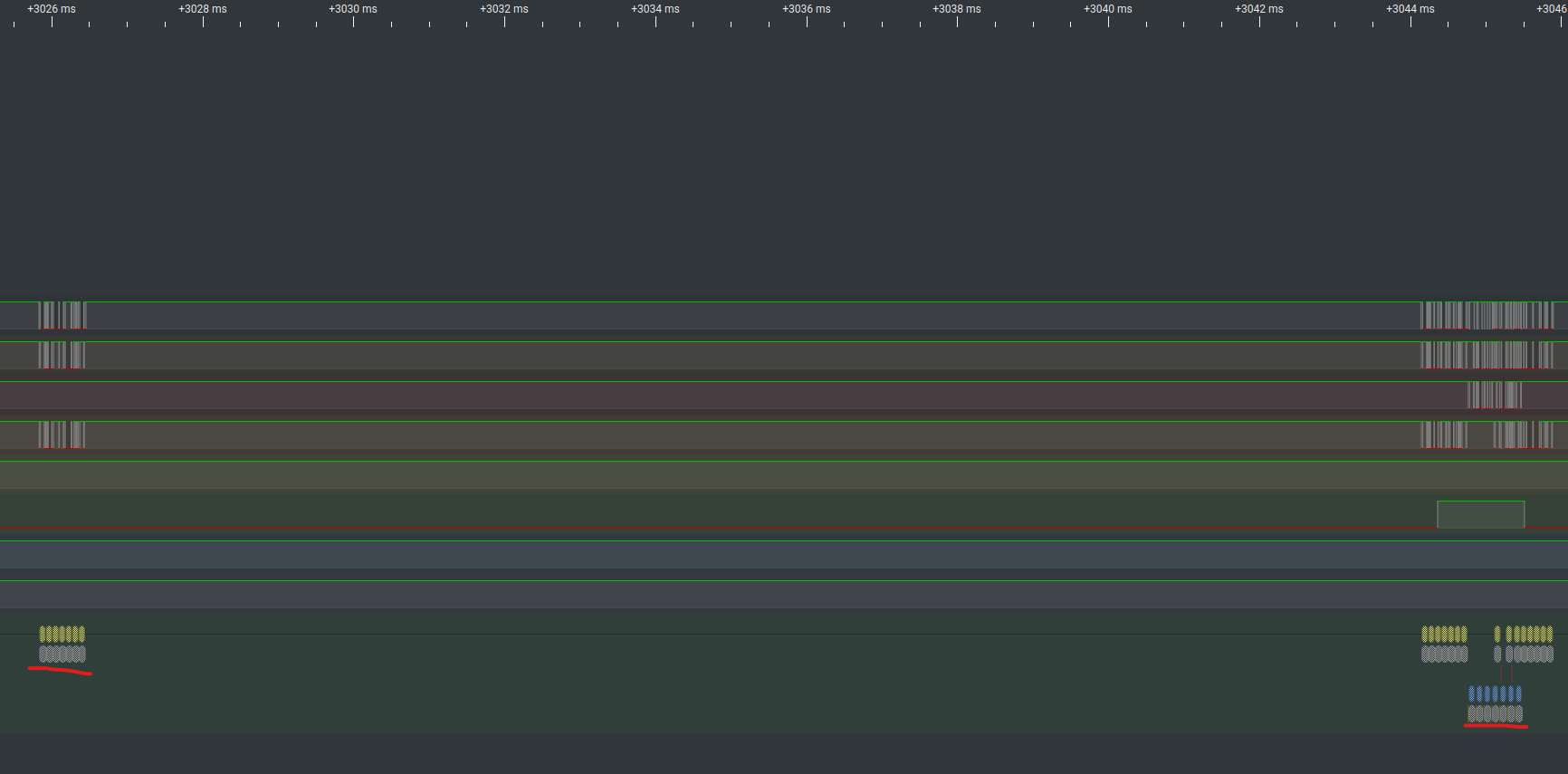

Hello
I have an ESP32-C6 running ESP-IDF 5.4.1
I have set ut an RS485 connection with half duples mode and an RTS pin.
I'm trying to set up a function that should respond to a specific message on the bus.
But when I check the bus the response is sent to the subsequent received message instead.
So my understanding is that there might be messages in the queue and the routine is responding to the message that's first in the queue and not the one that it's supposed to respond to.
With my code below, what am I doing wrong and how should I do instead?

I've tried to replace the parseData function with uart_write_bytes and it does no difference.
Here's the logic analyzer output, the message to the left is the one I want to respond to, but it responds to the 2nd instead causing a collision with the 3rd message.
Skärmbild 2025-05-15 154057.png (33.02 KiB) Viewed 67 times
Thanks in advance!

Postby MicroController » Fri May 16, 2025 8:47 am
Try setting a low(er) RX full threshold and/or RX timeout in order to be notified sooner of received data.
