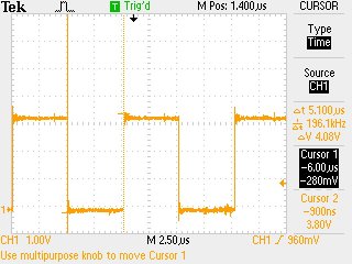

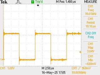

however, it generates a 99.01KHz square wave period 10.10uSec
the resolution is 10MHz and
const rmt_symbol_word_t pulsePattern[] = {
			{.duration0 = 50, .level0 = 1, .duration1 = 50, .level1 = 0},
should generate a square wave 5uSec high and 5uSec low
this shows the low is 5.1uSec (high is correct 5Usec)

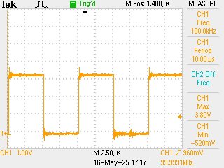

if I change the rmt_symbol_word_t to
			{.duration0 = 50, .level0 = 1, .duration1 = 49, .level1 = 0},
the generated frequency is then correct

Postby ok-home » Sat May 17, 2025 2:08 am
hi
for esp32
Note: When enabling the continuous transmission mode by setting RMT_REG_TX_CONTI_MODE, the transmitter
will transmit the data on the channel continuously, that is, from the first byte to the last one, then from the first
to the last again, and so on. In this mode, there will be an idle level lasting one clk_div cycle between N and
N+1 transmissions.
https://www.espressif.com/sites/default ... ual_en.pdf page 414
