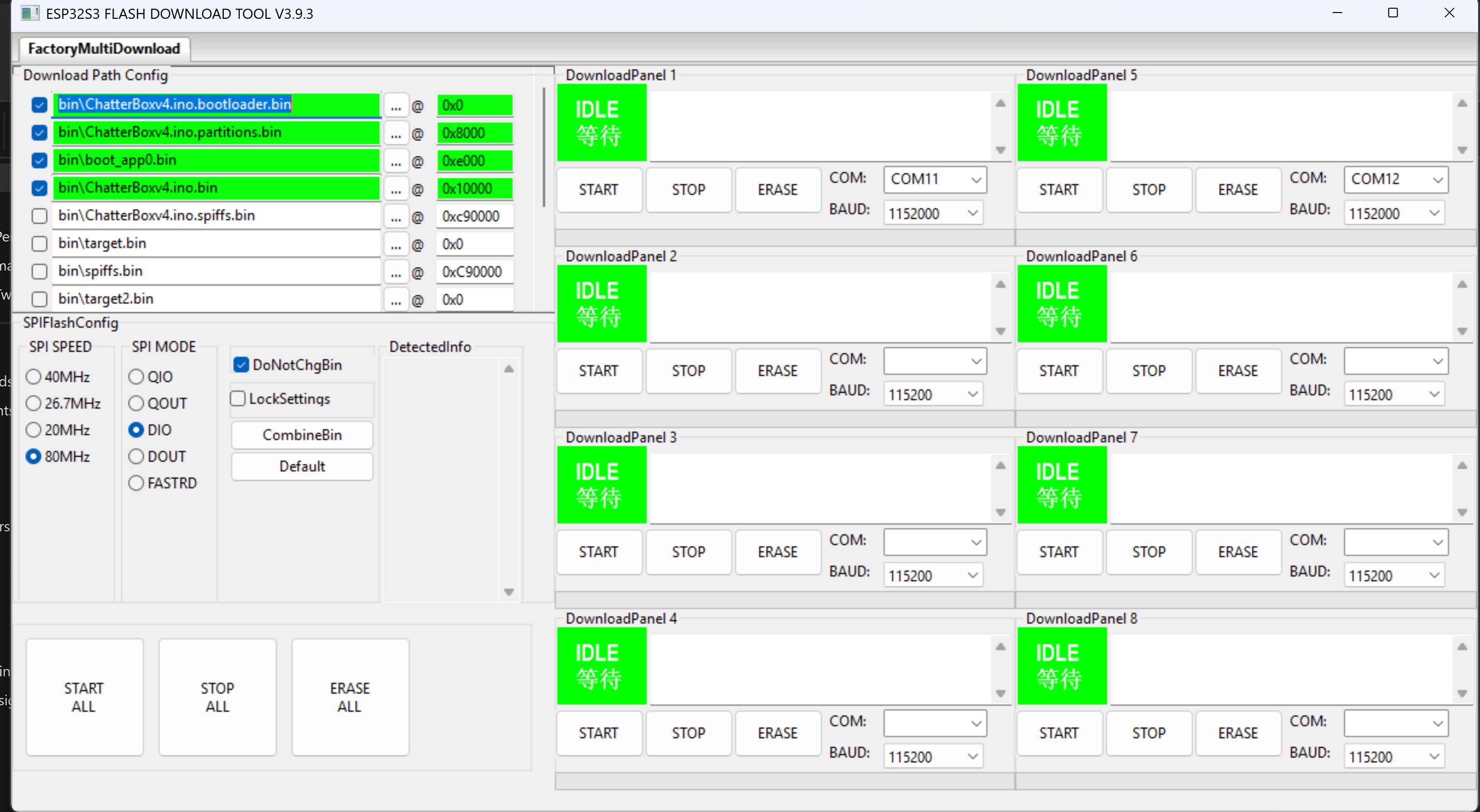

I the old version of the flash download tool i used to include my spiffs.bin but now when it get to this file it fails with com error. if i just send it i see it send the file then error sam com error . i am able to upload bootload,partionions,app0,main.bin with no issues if i use the file directly with esptool write flash in command line no issue why can i not have in the flash tool uploader

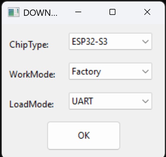

im not using the IDF directly using the flash download tool latest download from site 3.9.3 factory mode
The code is written in on Arduino ESP core 3.0.7 within Arduino it uploads fine I built the spiff file with in this

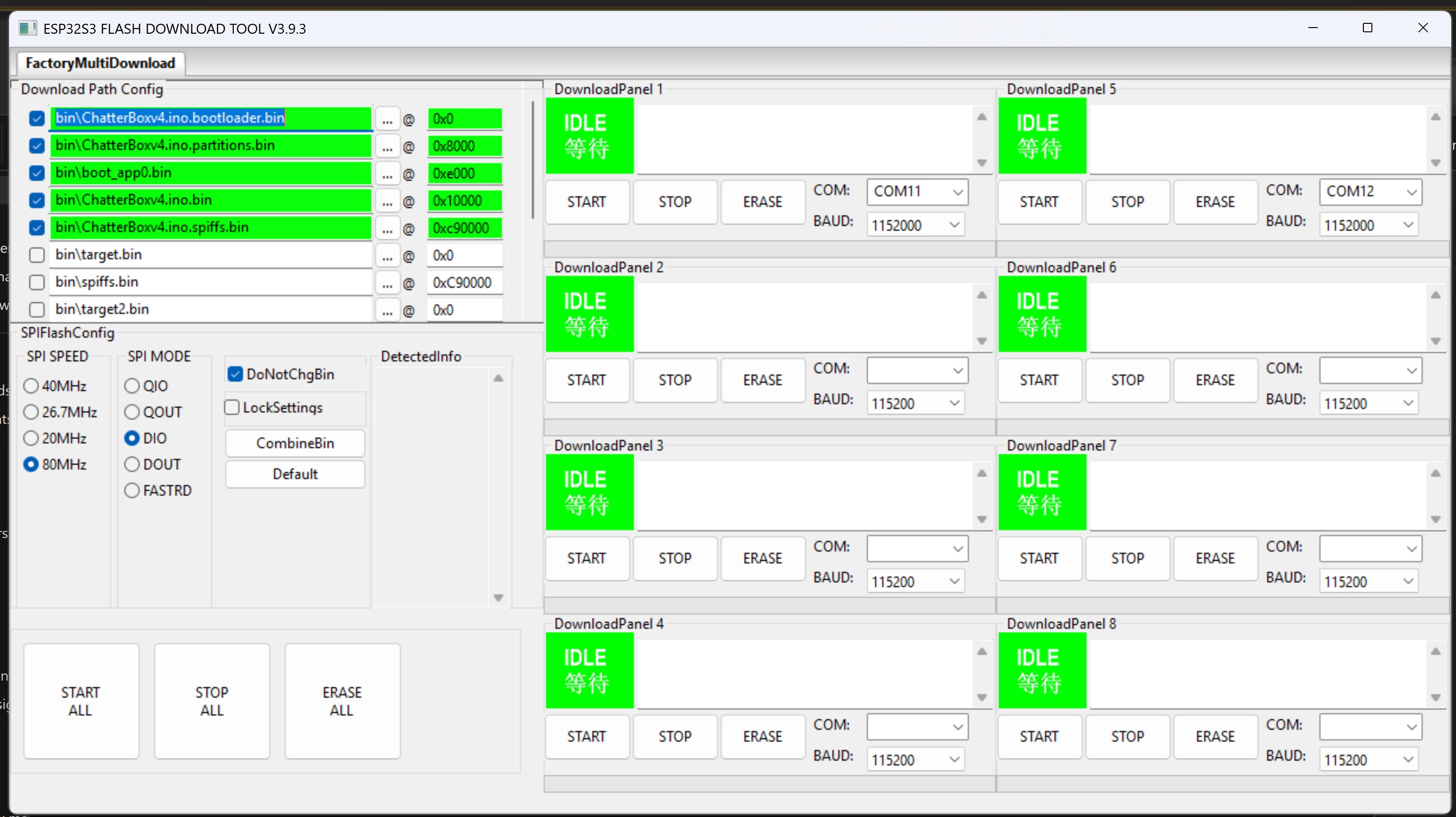

i took all bins everything uploads fine but if i add or try just the spiffs.bin it fails with com error
I have tried all different baud speeds no luck
If i upload via OTA there is no issue
setup
Screenshot 2025-06-16 132427.jpg (30.7 KiB) Viewed 134 times
this works fine
when i add spiff it fails with com error
get com failed.jpg (558.05 KiB) Viewed 134 times

I am sorry but I am not sure if I can help you if you're using a custom piece of software to do this. If you have Python and pip installed you can download esptool with `pip instal esptool` command and then try to flash the partition that way.
esptool.py --chip <your chip, e.g. esp32, esp32s3, etc.> -p <PORT> write_flash 0xc90000 <your binary file path .bin>
