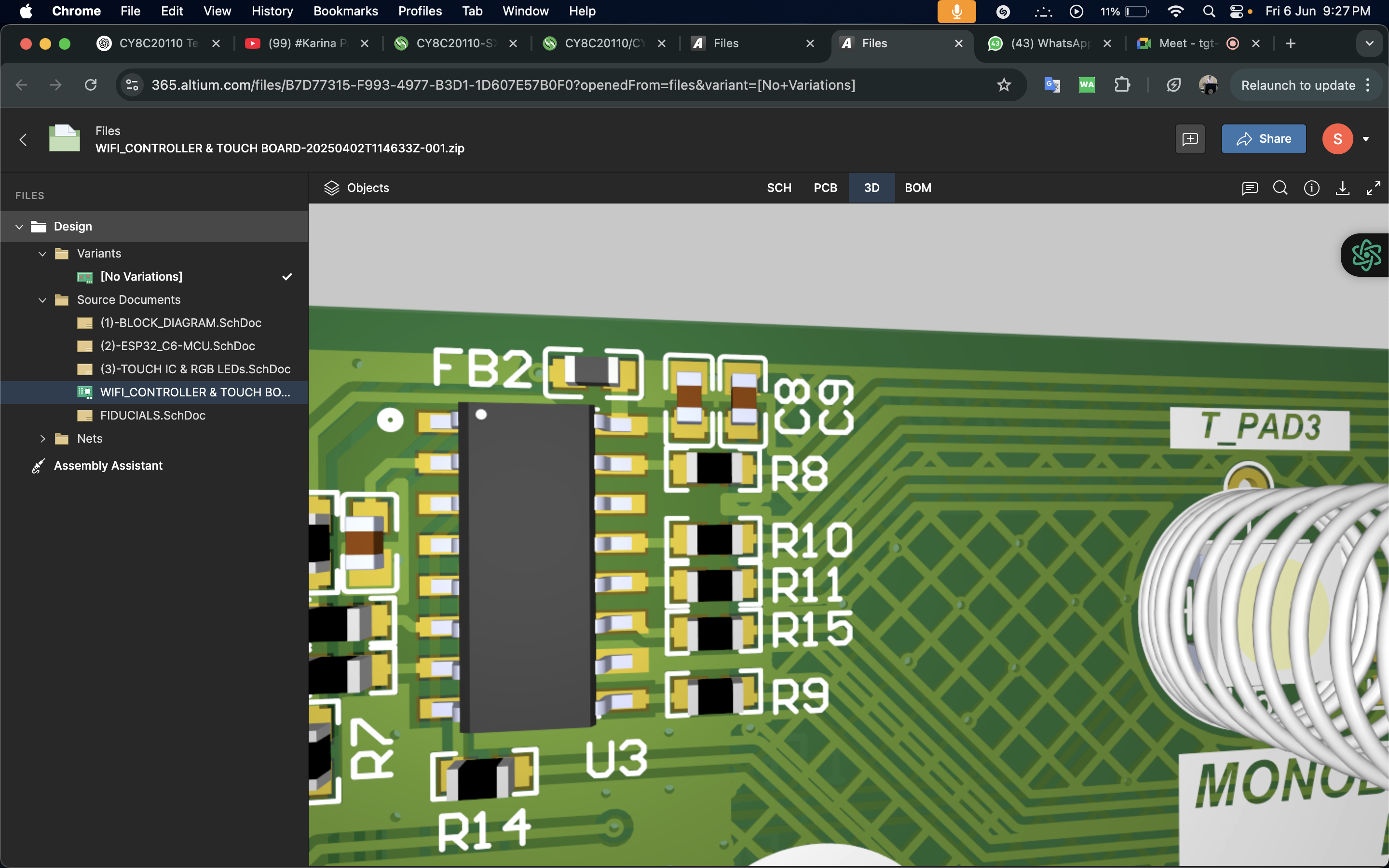

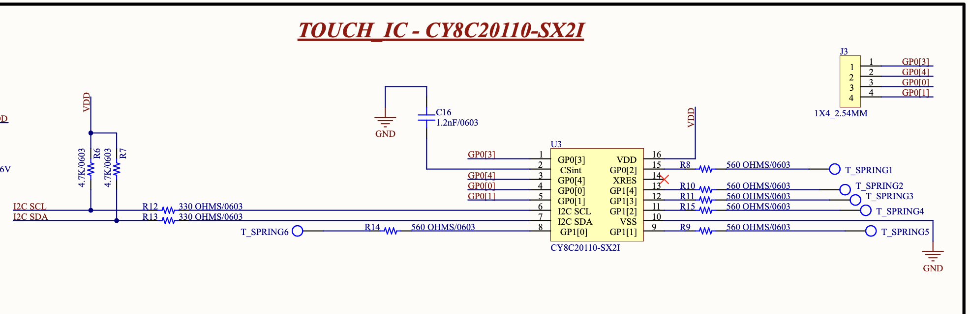

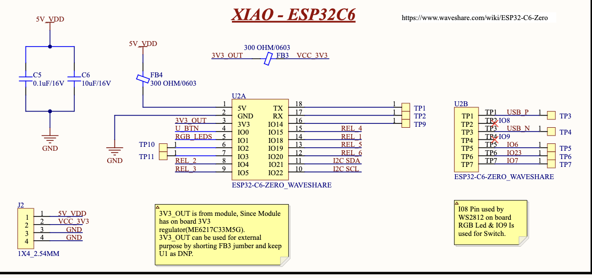

Hi all,
We’re working on a custom PCB under our startup “Slogfy” where we’ve integrated the CY8C20110-SX2I capacitive touch IC with an ESP32 microcontroller. However, we’re not able to receive any data or touch status over I2C.
🔹 IC: CY8C20110-SX2I
🔹 Microcontroller: ESP32 (using Arduino IDE)
🔹 I2C Pins: SDA = GPIO21, SCL = GPIO22
🔹 Pull-ups: 4.7kΩ on SDA and SCL
🔹 I2C Address: 0x00 (or configured value)
🔹 Status: ESP32 detects device on I2C bus with scanner, but data read always returns 0 or fails.
We’ve attached:
📌 Our Schematic (PDF/image)
📌 PCB layout (image)
📌 Screenshot of serial output and code snippet

[im
Screenshot 2025-06-07 at 10.29.34 PM.png (156.52 KiB) Viewed 54 times
g][/img]
Screenshot 2025-06-06 at 9.27.16 PM.png (1.95 MiB) Viewed 54 times
Screenshot 2025-06-07 at 10.29.16 PM.png (175.96 KiB) Viewed 54 times

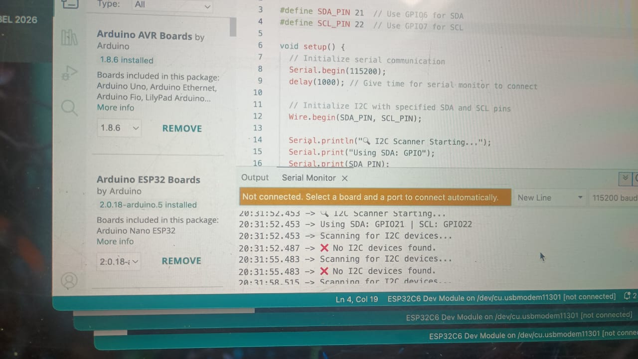

#include <Wire.h>
#define SDA_PIN 21 // Use GPIO21 for SDA
#define SCL_PIN 22 // Use GPIO22 for SCL
void setup() {
// Initialize serial communication
Serial.begin(115200);
delay(1000); // Give time for serial monitor to connect
// Initialize I2C with specified SDA and SCL pins
Wire.begin(SDA_PIN, SCL_PIN);
Serial.println(" I2C Scanner Starting...");
Serial.print("Using SDA: GPIO");
Serial.print(SDA_PIN);
Serial.print(" | SCL: GPIO");
Serial.println(SCL_PIN);
void loop() {
byte error, address;
int count = 0;
Serial.println("Scanning for I2C devices...");
for (address = 1; address < 127; address++) {
Wire.beginTransmission(address);
error = Wire.endTransmission();
if (error == 0) {
Serial.print("✅I2C device found at address 0x");
if (address < 16)
Serial.print("0");
Serial.println(address, HEX);
count++;
if (count == 0)
Serial.println("❌No I2C devices found.");
else
Serial.println("✅I2C Scan Complete.\n");
delay(3000); // Scan every 3 seconds
"serial print is-❌No I2C devices found."
WhatsApp Image 2025-06-07 at 8.32.44 PM.jpeg (91.3 KiB) Viewed 48 times
