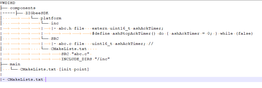

I am getting undefined referance to error in my esp32 project
below is my project sturture
VWDIHD
├── components
| ├── ZIGbeeSDK
│ └── platform
│ └── inc
| | |- abc.h file extern uint16_t ashAckTimer;
| | #define ashStopAckTimer() do { ashAckTimer = 0; }
│ └── SRC
| | |- abc.c file uint16_t ashAckTimer; //
│ └── CMakeLists.txt
| SRC "abc.c"
| INCLUDE_DIRS "/inc"
├── main
│ └── CMakeLists.txt [init point]
|- CMakeLists.txt
the error i am getting is
undefined reference to `ashAckTimer'
FYI : kept header file in source "abc.c" file
Kindly let me know the reason
using espidf v5.4.1 with zigbee SDK4.4.6

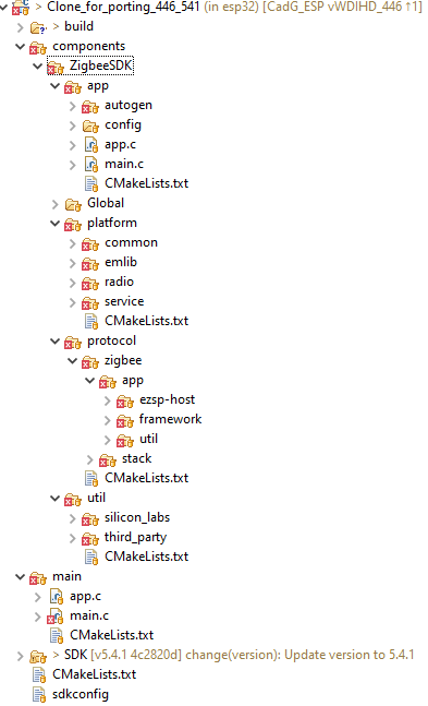

Attached a image of projet where getting error

From what you show I'm pretty sure there are more errors and/or warnings put out by the build process, which are relevant.
As a start, change
to
in the CMakeLists.txt.
As a start, change
SRC "abc.c"
INCLUDE_DIRS "/inc"
SRC "SRC/abc.c"
INCLUDE_DIRS "inc"
kesha.modhia
- Posts: 54
- Joined: Fri May 13, 2022 12:36 pm
Re: Getting ": undefined reference to " error in project directory
Yes, I already have written that as you suggested

For your information my project directory looks like attached image,
Above given is just small represantation of my issue so that i can explain you clearly.
Attached CMakelist.txt of platform for better understanding.
