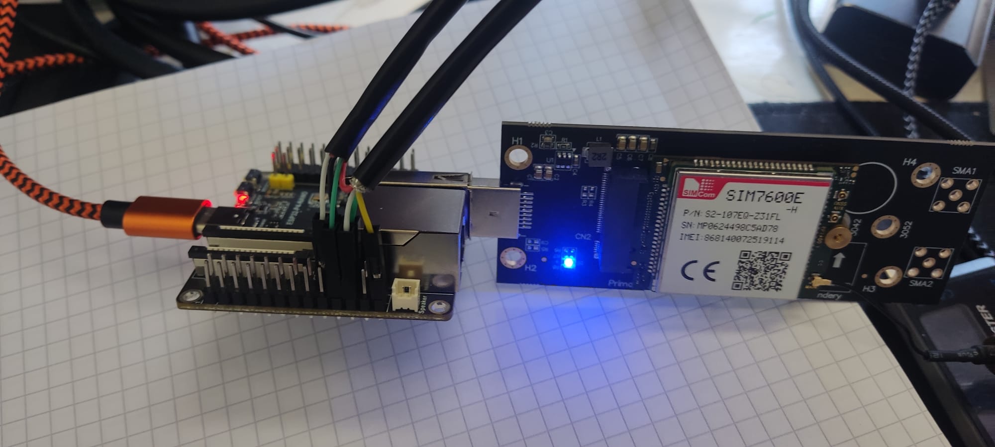

Okay for anyone interested I think I got it working, the setup is like this:
  • Waveshare ESP32-P4 Nano
  • USB -> Serial on the main USB port of the waveshare board, connected to PC
  • USB JTAG/Serial on GPIO24/GPIO25, connected to PC
  • USB FS Device on GPIO26/GPIO27, connected to PC
  • USB HS Host on D+/D- connected, connected to SIM7600E module
Result:
  • on the PC I have ttyACM0 (usb to serial), ttyACM1 (JTAG/Serial) and a cdc_ncm network interface (USB OTG FS / tinyusb)
  • I can open both ttyACM terminals (usb serial + jtag/serial)
  • I can ping the ESP32-P4 through the cdc_ncm interface
  • I see esp_modem establishing the connection to the SIM7600E (but it's not working because of RX buffer append not supported on P4 and hence not supporting SIM7600 modules, but I can just use a different 4g module)
Steps:
  • ESP_Modem uses the USB Host library and the USB host library support only the USB HS interface at the moment (and it's hardcoded). So the main limitation at the moment is that you can't use the slower usb port for host and the fast one for device
  • TinyUSB supports only once instance at a time but isn't used for ESP_modem and USB Host so it's not an issue. Just go in the config of ESP-IDF and make sure to select OTG1.1 as the USB Peripheral for TinyUSB (this will use by default USB FS on GPIO26 and GPIO27)
So it looks to be mostly working, I will need to do more tests but it seems to be working fine. It also looks like the 3 USB peripherals on te ESP32-P4 can be used at the same time (HS, FS, Serial/JTAG)
