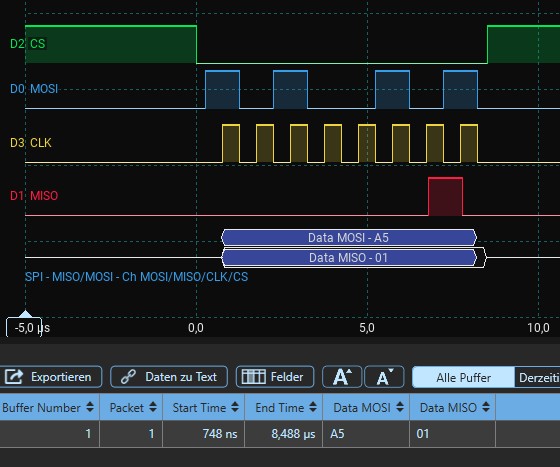

Dear Community,
I'm using a ESP32 WROOM-32D. It should work as a SPI slave connected to a PIC32. This SPI is working very well, cecause there are some other devices connected.
I adapted the SPI excample from the Espressif to my setup (see att. main.c, he_spi.h). In the main loop I inserted a timer with a counter, just to see the progran is alive. To have a visible pattern, I preload the first Byte of the SPI-receive-buf with 20 and print this Byte out, bevore and after the SPI is receiving a Byte. The PIC-MCU ist sending a 0xA5 (see OsziPIC MOSI signal).
c_files.zip
(2.13 KiB) Downloaded 16 times
The problem is, the Byte after receive is not changed in the receive buf. I expect the 0xA5 (165 dec) but it is still the 20 (dec). The Oszi-PIC is showing, that the ESP SPI is sensing the transfer, because the MISO line is clocking the 1, whitch is preset in the ESP SPI send-buf. As you can see in the TerminalOut, I tryed it several times (after Main Loop 11, 19, 25).

Each time with the same result. I checked the ESP MOSI pin. I configured it as a ordinary GPIO input and verified the correct high/low lewel. For my verivication, I puted the relevant code into the main.c, but with the same failure.
I attached my .c files for your information.
For my opinion, there should be somthing wrong with the memory setup. But up to now no idea about a solution.
What could be wrong?

Hi, for esp32 it use an old design, If you using DMA and actual transaction length (master side) not align to 4 byte, slave can't receive those not aligned bytes.
So for your solution: change PIC master side that transaction length align to 4 bytes, Or not use DMA on esp32 spi slave.
Thanks for your report!

It needs to align to four, in other words, be an integer multiple of four. So 0 bytes, 4 bytes, 8 bytes, 12 bytes, 16 bytes, 20 bytes etc all should work.

thank you for your great support. I checked out your advices (with/without DMA) and could verify the solution.
