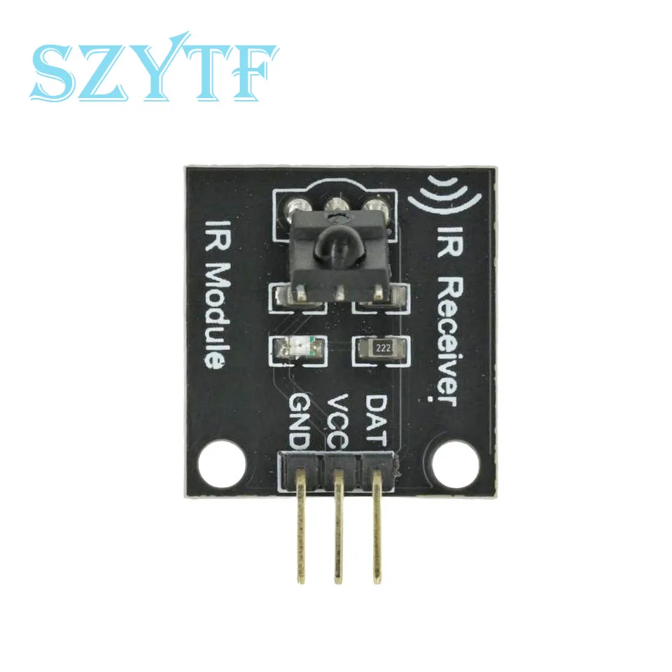

I don't have a logic analyzer available right now, but I can provide more context. I'm transmitting RC6 code 0x2401 using an Arduino with IRremote library. The transmitted signal should be a standard RC6 frame with ~22-24 symbols, but my ESP32-S3 RMT RX consistently captures only 19-20 symbols before truncating. The timing seems correct (~23ms total duration) but the frame is incomplete. Could this be related to RMT idle detection or end-of-frame detection triggering too early?
Let me also share a photo of my IR receiver module
