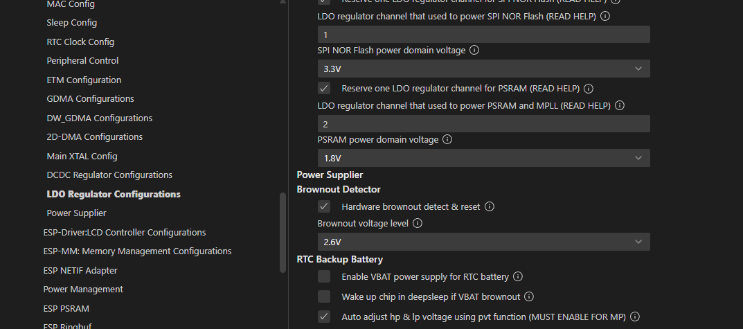

Has anyone had luck with this? Using VSCode extension I can find VBAT settings that seem relevant. I am specifically trying to keep the RTC through power loss. Following the above links gave me a variety of results. I was able to get RTC to persist through power loss, but booting became very inconsistent. It would be nice if Espressif could provide an example or improved documentation.

You have to go into menuconfig to enable VBAT.
Screenshot 2025-12-29 191118.png (58.19 KiB) Viewed 2790 times
