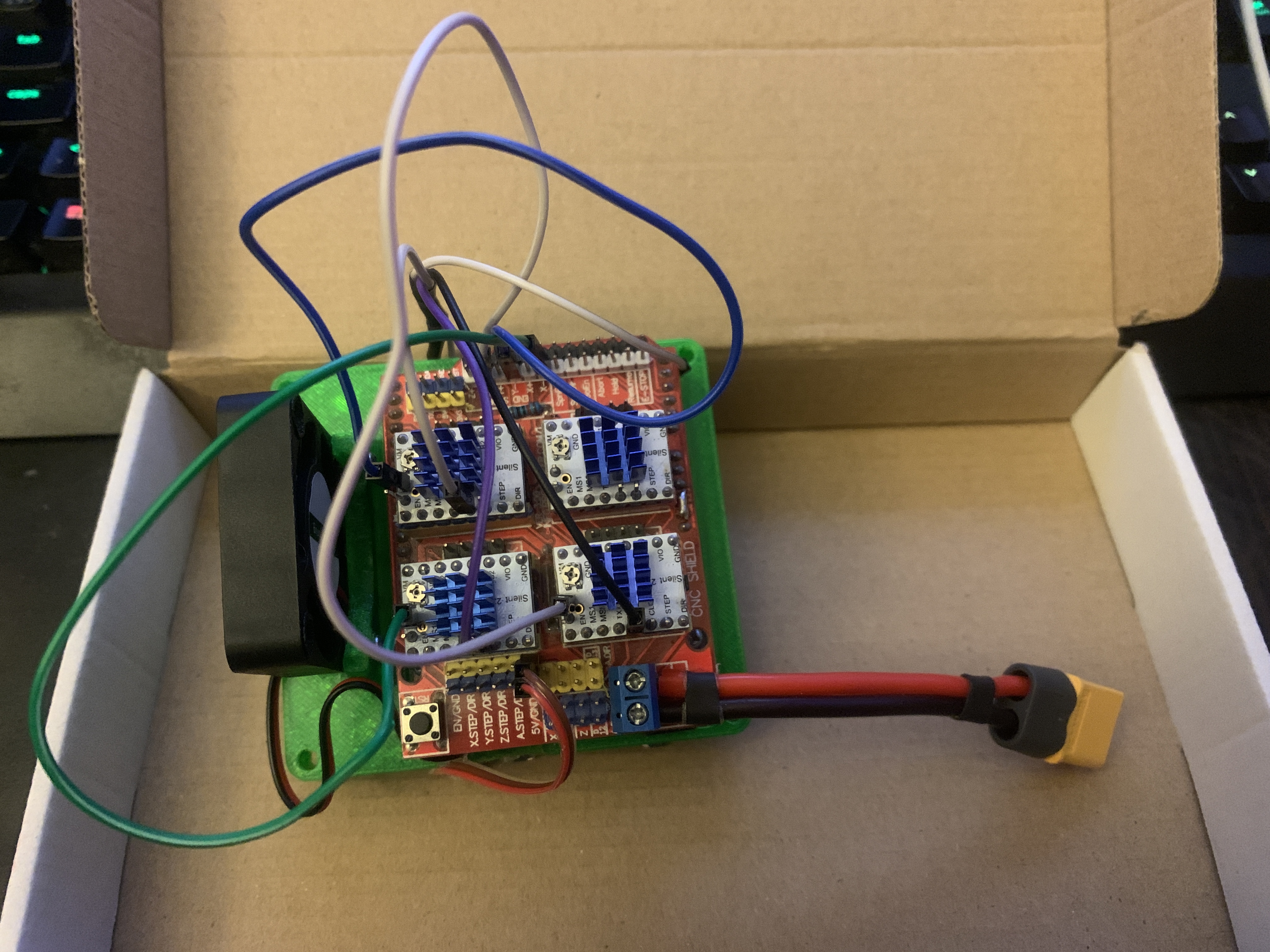

I have a CNC Shield V3 on top of an AliExpress bought ESP32-S3 N16R8 "uno" (https://www.aliexpress.com/item/1005006 ... 18028Q78JE) with 4x TMC2209 stepper drivers (technically 3, driver "A" is not actually plugged in to the uart or a stepper, i just keep it there as a spare). The CNC Shield V3 has a single modification done to it, i've cut the 5V leg and bridged it to 3.3V instead, since i wanted the TMC2209 drivers to use 3.3V as to not damage the ESP32. There's also an old Arduino SD Card reader that i slapped on their cause i wanted to use the ESP32-WebUI once i got everything going.

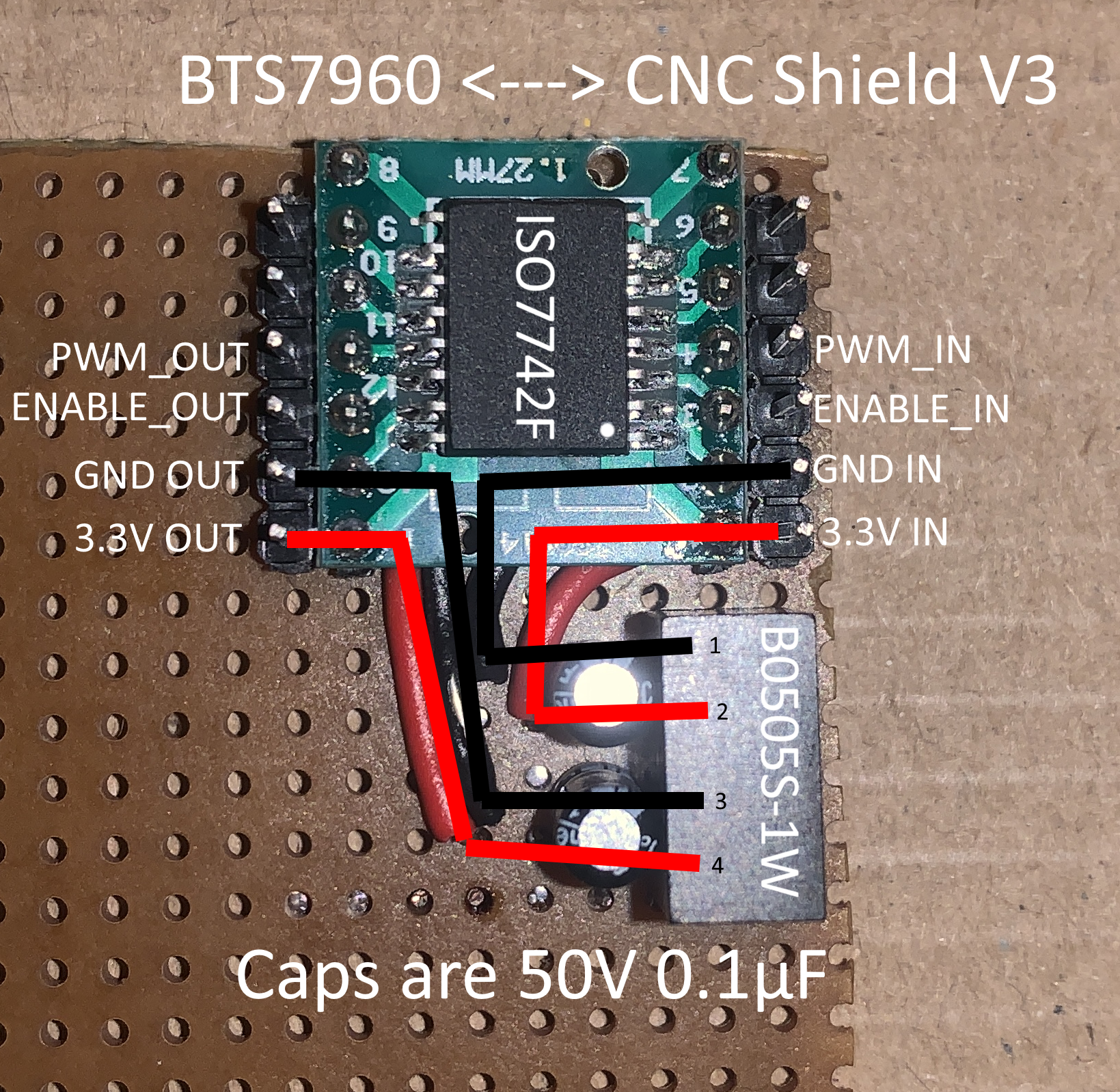

The ESP32/CNC Shield combo and the BTS7960 board were connected together with my own little board that is in the picture, which is an B0505S-1W to isolate the power, and an ISO7742F to isolate the PWM and ENABLE signals for the spindle. (I hope that's what it does anyway, like i said, not really super knowledgeable about electronics, just know some basics)

At this point GrblHAL is usually done booting and i can start sending commands, but not this time, it was completely unresponsive, so i hit the reset button on the board and at that point it didn't respond to anything anymore, so i took the CNC shield off and noticed the actual ESP32-S3 board was hot to the touch, likely meaning i had somehow shorted it and it's dead.

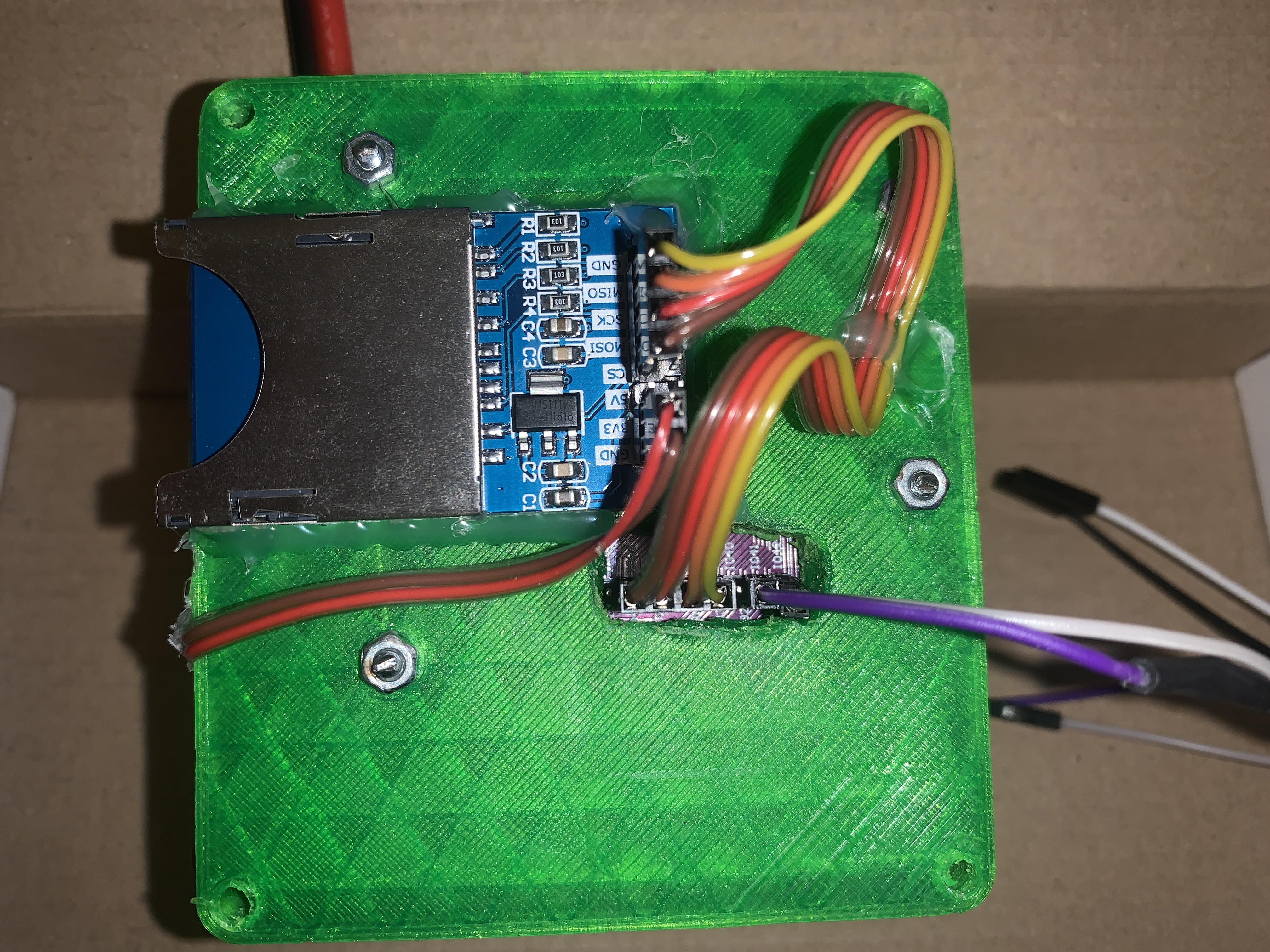

My isolation board
Front of ESP32/CNC Shield
Back of ESP32/CNC Shield

How is GND handled in your circuit? The B0505S (5V isolator used for 3.3V?) may be isolating part of your circuit's GND from the rest which may cause large voltage differences to occur, esp. with inductive loads on one side.

Yeah, i bought the 5V isolator before i decided to go with an ESP32, but it still seemed to work fine with 3.3V so just went with it.
I'm not quite sure what you mean by "how is GND handled", afaik the common ground would be the GND wire to the PSU for both the BTS7960 and the ESP32/CNC Shield, i was hoping the isolator would make no major voltage spikes pass through to the ESP. Other than the isolator the BTS and ESP are not connected in any way other than through the common PSU.
Also, at the time of the ESP death, the spindle was not enabled/sent a PWM, i was just moving the stepper's around, not sure if that changes something.
EDIT: Now that i think about it, there is another ground reference in the system, the one connected between the ESP and my PC, which if i remember correctly are not on the same mains circuit. Could that have caused a buildup somewhere and fried the ESP?
