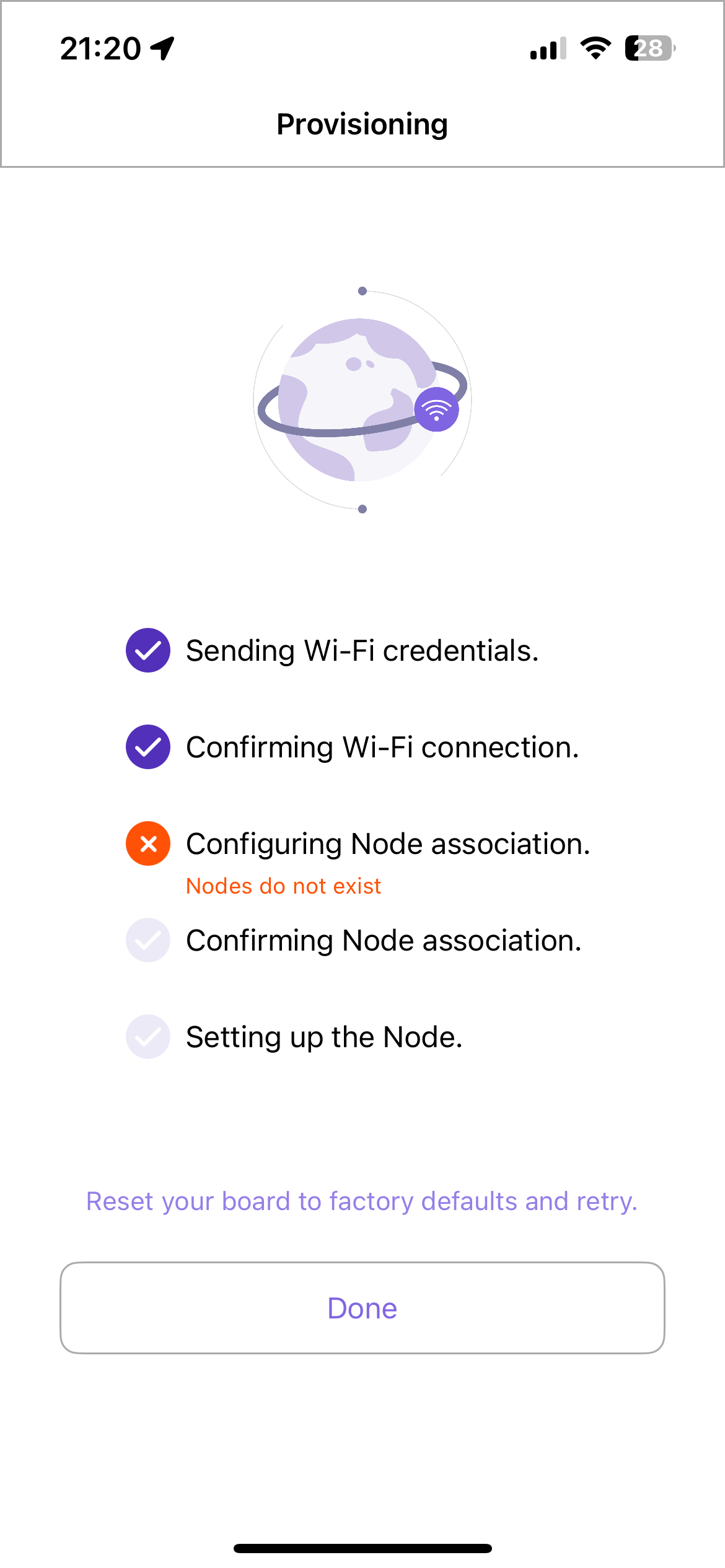

why use esp rainmaker app can not add rainmaker node running on esp32s3?But the same code running on esp32 can be added successfully。
through the esp32s3 serial debug log output,the esp32s3 can connect the wifi and connect the rainmaker mqtt cloud。But the app on configuring node association step encounter nodes do not exist。

Can you share the firmware side logs during the provisioning workflow and a screenshot of the last page of provisioning in the iOS app?
The ios app vesion is V3.4.0(f896deb):
The logs:
I (41662) app_wifi: Provisioning successful

I (45642) esp_rmaker_core: Waiting for User Node Association.
I (45642) esp_rmaker_ota_using_topics: Subscribing to: node/F412FAE2EE58/otaurl
I (45652) esp_rmaker_user_mapping: MQTT Publish: {"node_id":"F412FAE2EE58","user_id":"xxxxxxxxxxx","secret_key":"xxxxxxxxxxxxxxxxx","reset":true}
I (46232) esp_rmaker_user_mapping: User Node association message published successfully.
I (46232) esp_rmaker_param: Params MQTT Init done.
I (46232) esp_rmaker_param: Reporting params (init): {"Temperature Sensor":{"Name":"Temperature Sensor","Temperature":28.29000,"Humidity":80.08000,"Environment Humidity":65,"Battery Voltage":4.27500},"Motion Sensor":{"Name":"Motion Sensor","Motion Detection State":false,"Notify":true},"Light":{"Name":"Light","Power":false,"White Brightness":50,"Warm Brightness":50},"Local Control":{"POP":"01dbcc92","Type":1}}

Are you using the phone app from China region? In that case, since ESP32 uses assisted claiming, it will work fine, but ESP32S3 uses "Self Claiming" by default and so it will connect to global RainMaker deployment instead. Please use Assisted Claiming on ESP32S3 too. You can check details here.

Yes,from China region. Thanks for your reply. I will have a try.
