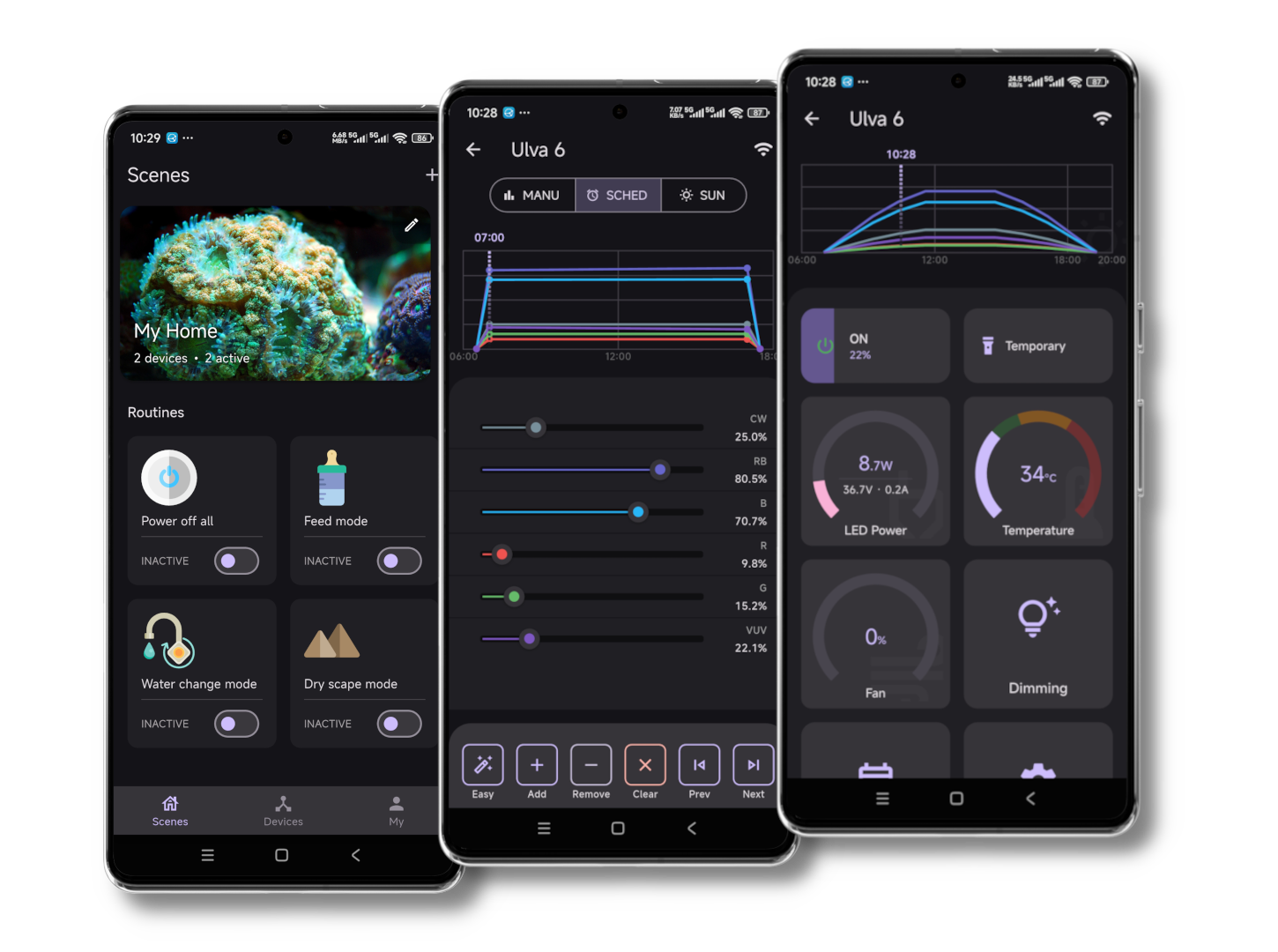

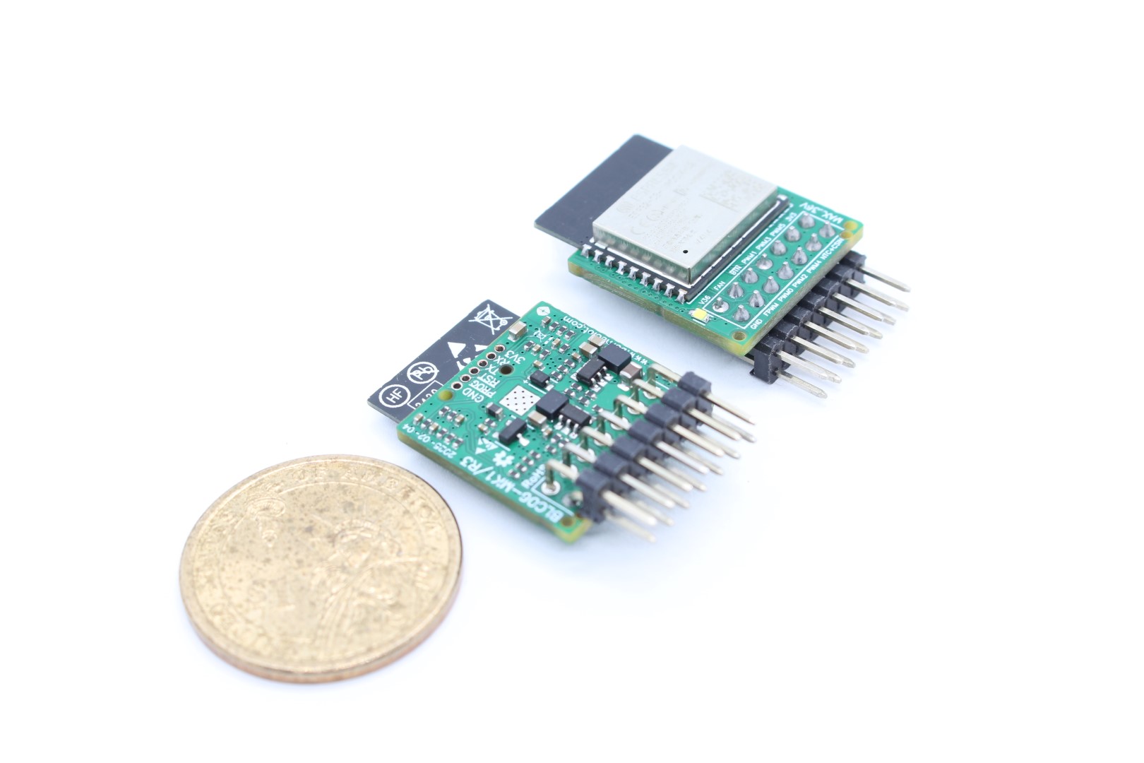

Hi all, this is my first post here. I wanted to share Buce, an open-source aquarium LED controller I developed using the ESP32-C3, and give a technical overview. Some of you might find it interesting for DIY lighting or ESP32 projects.
Buce is a compact controller supporting 6 independent PWM channels, high-resolution dimming, and flexible dimming curves. It’s designed to be modular, reliable, and fully customizable.
Key technical points:
  • ESP32-C3 for Wi-Fi connectivity, OTA firmware updates, and remote control.
  • Independent PWM channels with 12-bit resolution for smooth lighting.
  • Supports multiple dimming curves (linear, logarithmic, exponential, CIE1931) for realistic lighting simulation.
  • Fully open-source hardware and firmware (OSHWA certified).
  • Built-in over-temperature and over-voltage protection.
  • Managed via an Android app (iOS version in development).
All design files and source code are open-source in here: https://github.com/borneo-iot/borneo. If you don't want to join the crowdfunding, you can take the files and manufacture the PCB yourself.
Crowdfunding page for those interested:
https://www.crowdsupply.com/borneo-iot/ ... controller
I'd love to hear feedback, ideas, or suggestions from the community. Thanks!

Thank you, where did you get the PCB fabricated from?
mingshu
Joined: Wed Dec 18, 2024 7:41 am
Re: ESP32-C3 Based Open Source Aquarium LED Controller & App
Postby mingshu » Sun Sep 28, 2025 3:15 am
JLC PCB.
