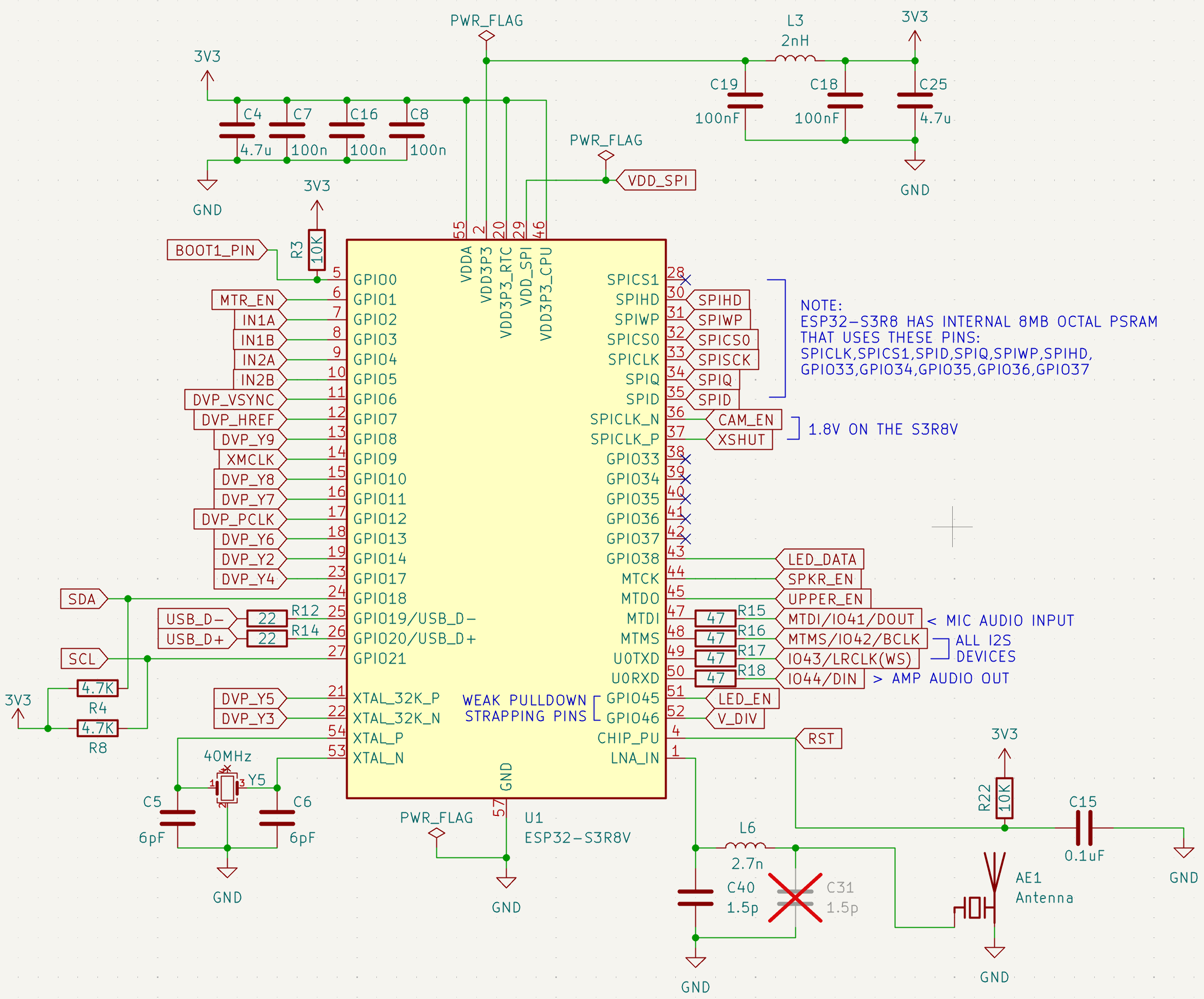

I'm not sure if the S3R8V has different configuration requirements or maybe I'm using a pin I'm not supposed to? I attached an image of my pin usage for reference and I'm happy to provide more info. Here is the esptool output I get from my board:

IO45/46 are floating on my current hardware and I used SPICLK_N and SPICLK_P for enable signals. This seems like a hardware issue but I'm not sure where to look.

I'm not seeing decoupling caps on Vddspi, do you have them elsewhere? If not, add an 1uF and 100nF in parallel to ground, see if that helps.

Sorry for not including the flash layout. I did have the 0.1/1uF caps on my VDDSPI rail.

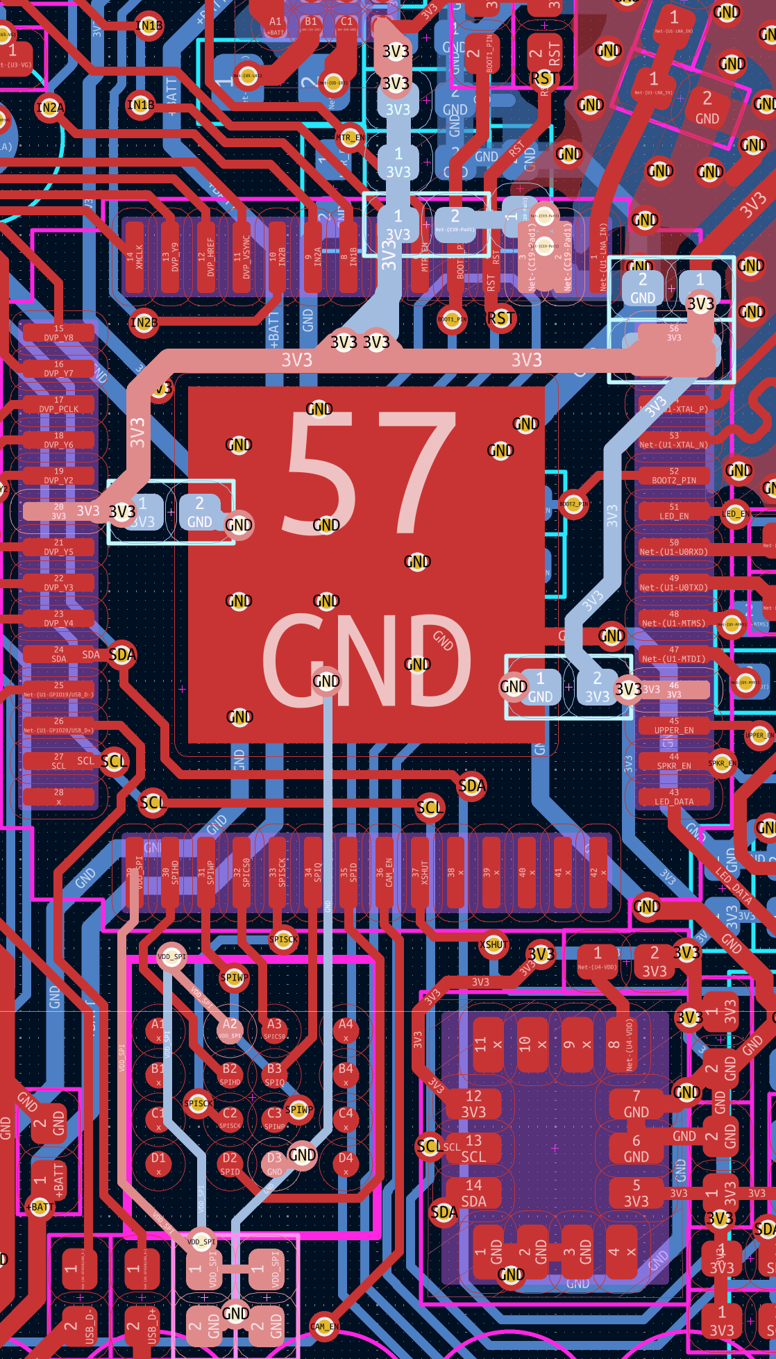

I have a feeling that this could be a power issue. Does enabling PSRAM cause the ESP32 to draw more power? I have a 2 layer, 0.33oz copper, flex PCB so power is a real concern. Looking back over my power distribution I found a 0.2mm wide choke point on the VDD3P3 rail. I'm also suspicious of the 2nH 0201 inductor in series (rated for 600mA, DCR: 120mOhm). From my research the internal PSRAM uses the VDD3P3 rail so these issues seem to line up?
I attached my board layout where my rookie mistakes are obvious. I'll bridge 3.3V to those pins to see it that solves the issue.

I soldered a wire to improve power distribution but it made no difference.
