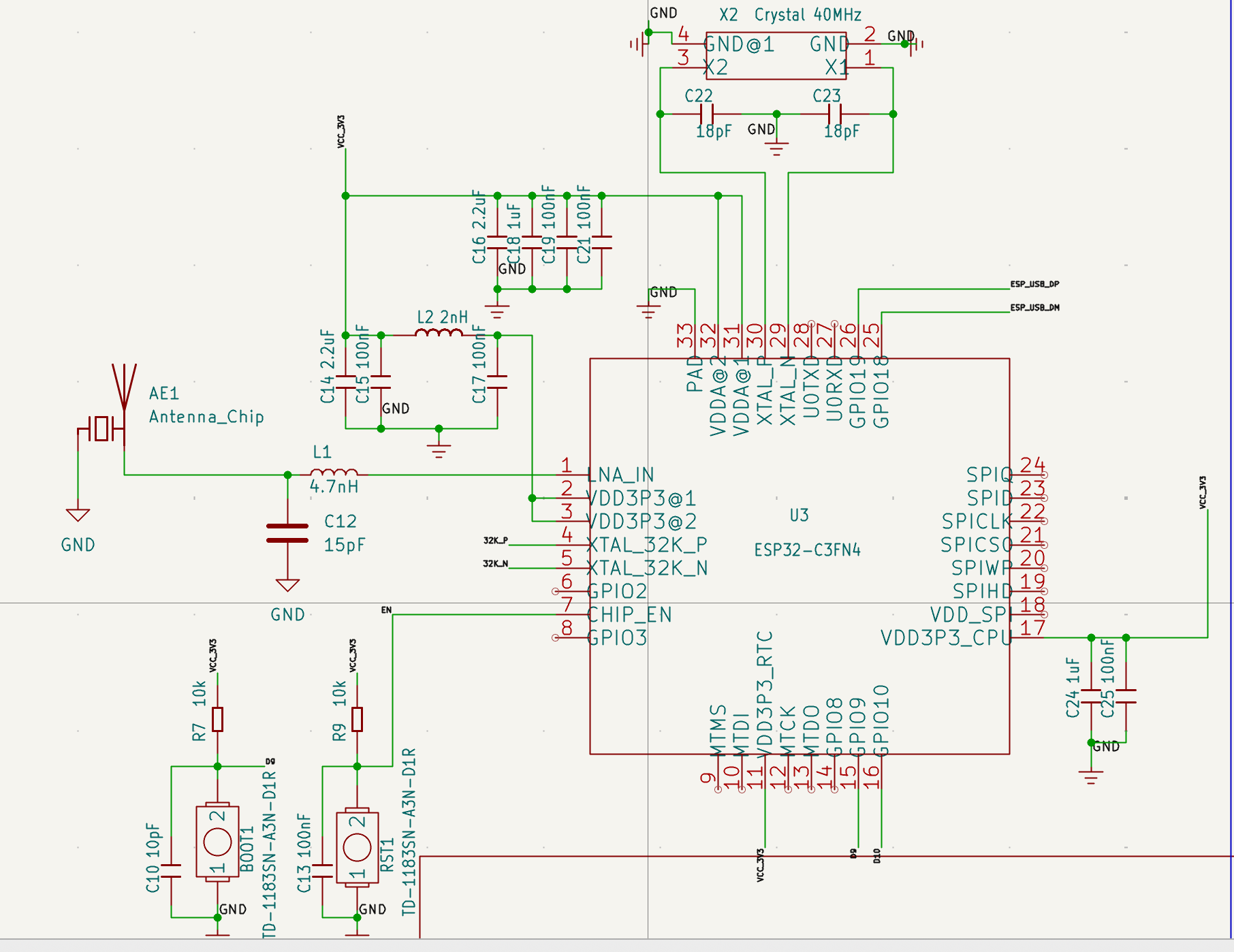

I have a custom ESP32-C3 board taken from the reference manual, it has all the necessary decoupling capacitors and inductors for Vcc. I measured 3.3V on Vcc going to all the power pins on the ESP32. My USB is also connected to the ESP32 (I use a USB adapter) but my computer does not detect the USB device when I plug it into the computer. D+ and D- are connected to GPIO19 and GPIO18 respectively.
I have attached my ESP32 circuit diagram.
I am currently clueless as to what the problem could be and what other methods I should try to find out and fix it.
Any advice would be greatly appreciated!

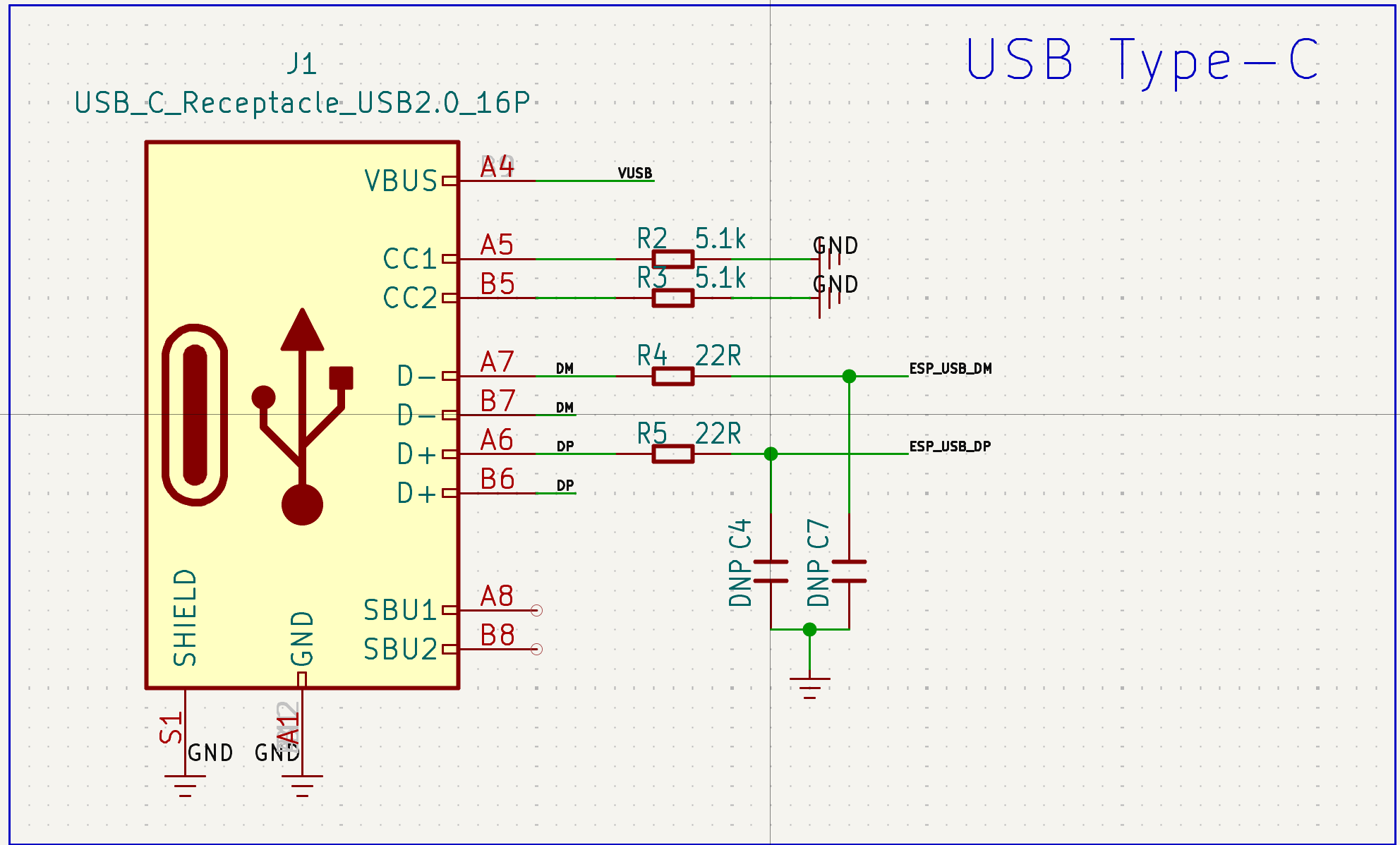

and USB Type connected to my ESP32C3 Chip

- You're missing the caps on VDD_SPI. You want an 1u/0.1u cap combo to ground on that pin, if memory serves. (Not directly related to your current issue, but you might want to add those to prevent issues further down the line.)
- Your USB-C connector should short the two DM connections together, same for the DP connections. At the moment, your USB-C connector only works one way. If you're not getting a connection, try flipping the USB-C plug upside down, chances are it will connect then.

The (first stage) bootloader, the one which you use to flash the chip and which also listens on the USB port, is in ROM from the factory, so there's no need to flash it. If you don't see an USB device before you did anything with the chip software-wise, it's 100% a hardware error.
