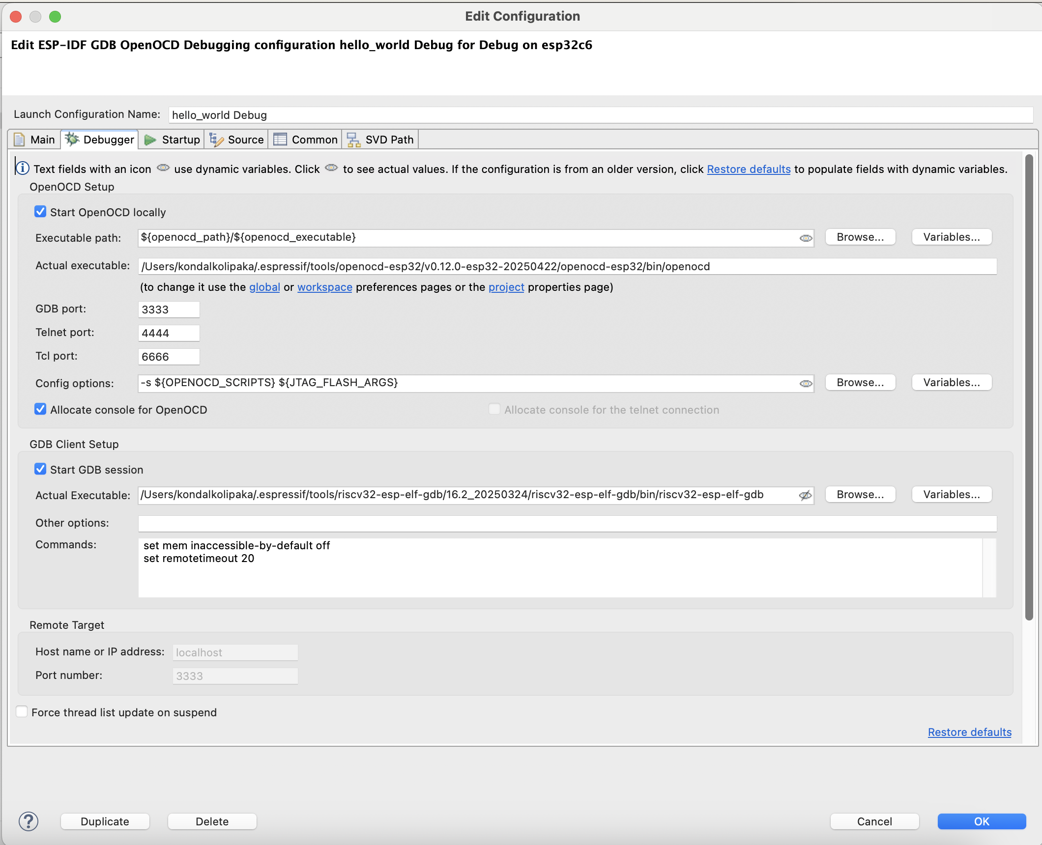

From the error, it seems that the GDB client is not auto-configured for some reason.
Kindly verify the following setting in the Debugging Editor Configuraiton dialog
In the GDB Client setup group, - look for actual executable by clicking on the "eye" icon and see if that shows the correct path
Please share the error log so we can check what’s causing this issue.

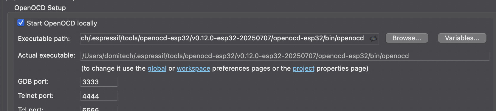

Re: Espressif IDE
The debug executable path looks ok to me:
/Users/domitech/.espressif/tools/openocd-esp32/v0.12.0-esp32-20250707/openocd-esp32/bin/openocd
The error log is the following:
