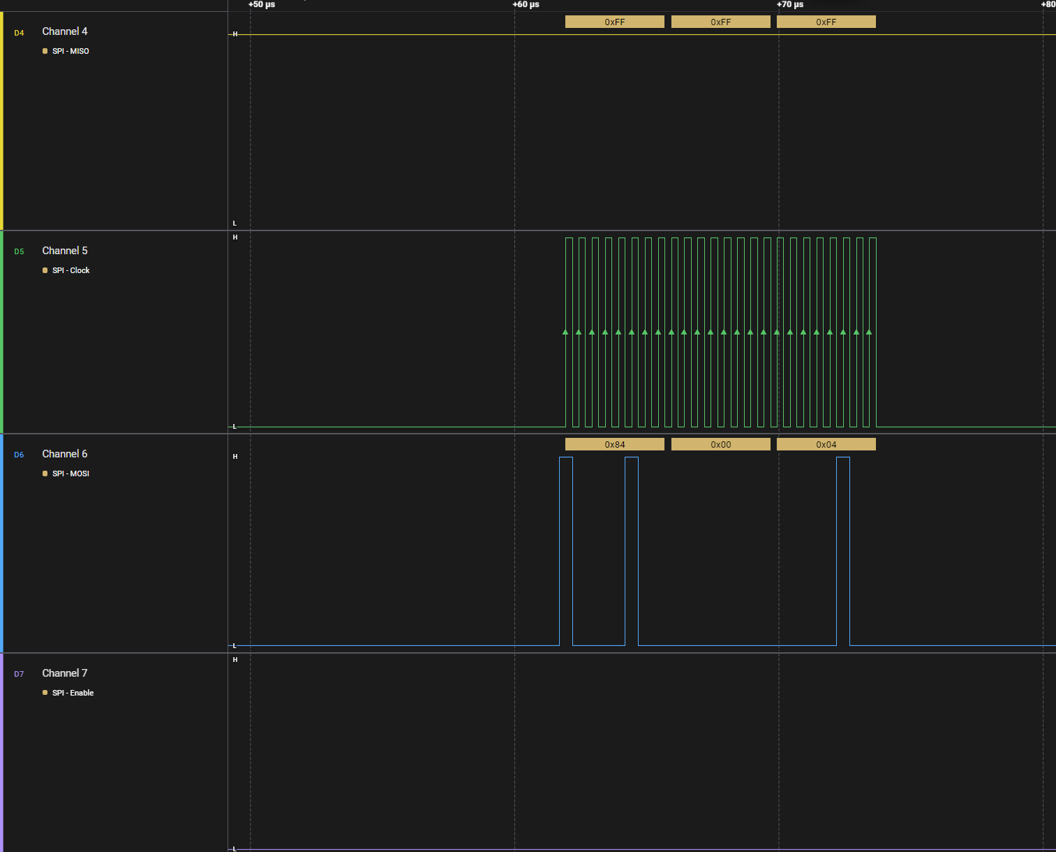

I am trying to perform a simple SPI transaction of 3 bytes, and the ESP32C6 hangs when doing
spi_device_queue_trans
Here is what I am doing:

I am setting up the bus like so:

Here is what I get for my logs:
I (356) dwt_init: dwt_initialise: About to call dwt_write16bitoffsetreg(SYS_CFG_ID=4, 0, 0x0400)
I (356) dwt_init: dwt_write16bitoffsetreg: Entering, regFileID=0x04, regOffset=0, regval=0x0400
I (366) dwt_init: dwt_write16bitoffsetreg: Buffer prepared [0x00, 0x04], about to call dwt_writetodevice()
I (376) dwt_init: dwt_writetodevice: Entering, recordNumber=0x04, index=0, length=2
I (376) dwt_init: dwt_writetodevice: Header prepared, cnt=1, header[0]=0x84, about to call writetospi()
I (386) deca_spi: writetospi: Entering, headerLen=1, bodyLen=2
I (396) deca_spi: writetospi: SPI initialized, about to acquire mutex
I (396) deca_mutex: decamutexon: About to take mutex
I (406) deca_mutex: decamutexon: Mutex taken successfully
I (406) deca_spi: writetospi: Mutex acquired
I (416) deca_spi: writetospi: Preparing transaction structure
I (416) deca_spi: writetospi: Total length=3 bytes
I (426) deca_spi: writetospi: Allocating TX buffer of 3 bytes
I (426) deca_spi: writetospi: TX buffer allocated successfully
I (436) deca_spi: writetospi: RX buffer allocated successfully
I (436) deca_spi: writetospi: Copying header, length=1, header[0]=0x84
I (446) deca_spi: writetospi: Header copied
I (446) deca_spi: writetospi: Copying body, length=2
I (456) deca_spi: writetospi: Body copied
I (456) deca_spi: writetospi: Transaction prepared, length=24 bits, rxlength=24 bits, flags=0
I (466) deca_spi: writetospi: Acquiring SPI bus
I (476) deca_spi: writetospi: SPI bus acquired
I (476) deca_spi: writetospi: Setting CS low before transaction
I (486) deca_spi: writetospi: CS set low
I (486) deca_spi: writetospi: Starting SPI transaction with spi_device_transmit()
As you can see from the attached image, the write happens just fine, but it just hangs after "Starting SPI transaction..."
I have tried with
spi_device_polling_transmit
as well, but it does the same thing...
Screenshot 2025-11-13 211956.png (60.57 KiB) Viewed 2222 times

Postby nopnop2002 » Sat Nov 15, 2025 3:54 am
I don't know why, but there is no MISO signal.
NicolasMontoya
Joined: Fri Nov 14, 2025 3:12 am
Re: ESP32C6 - spi_device_queue_trans hangs
Postby NicolasMontoya » Mon Nov 17, 2025 2:48 pm
Yes its becaues the CS stays high the entire time.. For some reason the SPI driver cannot take control of the CS line..
nopnop2002
Posts: 362
Contact:
Postby nopnop2002 » Tue Nov 18, 2025 5:18 am
This is why the SPI driver is not controlling the CS line.
devcfg.spics_io_num = -1;                   /* CS handled manually */
