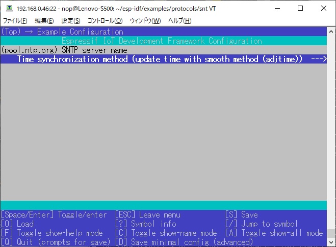

Here is official example.
https://github.com/espressif/esp-idf/tr ... ocols/sntp
You can select Time synchronization method with menuconfig.
The SNTP client task runs on background.
The time is synchronized every 3600000 milliseconds (1 hour).
This interval can be changed using sntp_set_sync_interval().
