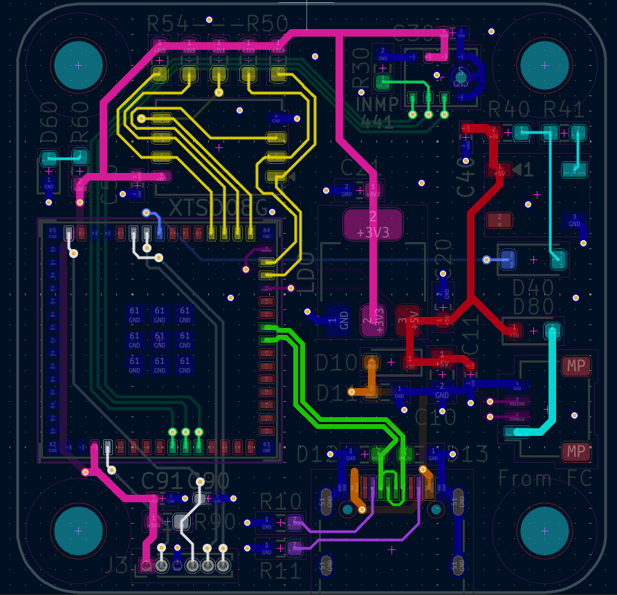

Hello everyone!
I’ve made some good progress here—I’ve been working on the PCB, which isn’t easy, but I have something to show you.
First, here’s the BOM (Bill of Materials) for the module—if you spot any inconsistencies or issues with the components, feel free to criticize or suggest improvements.
And then uou’ll find a view of the finished PCB design. As always, I’m open to criticism and suggestions, so don’t hesitate to share your thoughts.
Just to clarify, I’m still a beginner—I’ve been doing a lot of research, but I know I’m missing out on many best practices.
If needed, I can provide more screenshots.
Thanks to everyone for your past and future help, and most importantly—have a great day! 😊

emileletueur
Joined: Tue Jan 06, 2026 4:37 pm
Re: Schematic Review Request: ESP32-S3 Mini-1U + SDNand Flash + I2S Microphone for Drone Audio Logger
Postby emileletueur » Wed Jan 14, 2026 10:13 am
I add an XRAY view of Ground plane and just for fun an 3D view of PCB:
Posts: 10636
Postby Sprite » Thu Jan 15, 2026 12:10 am
Looks good, I see no immediate issues with that layout.
