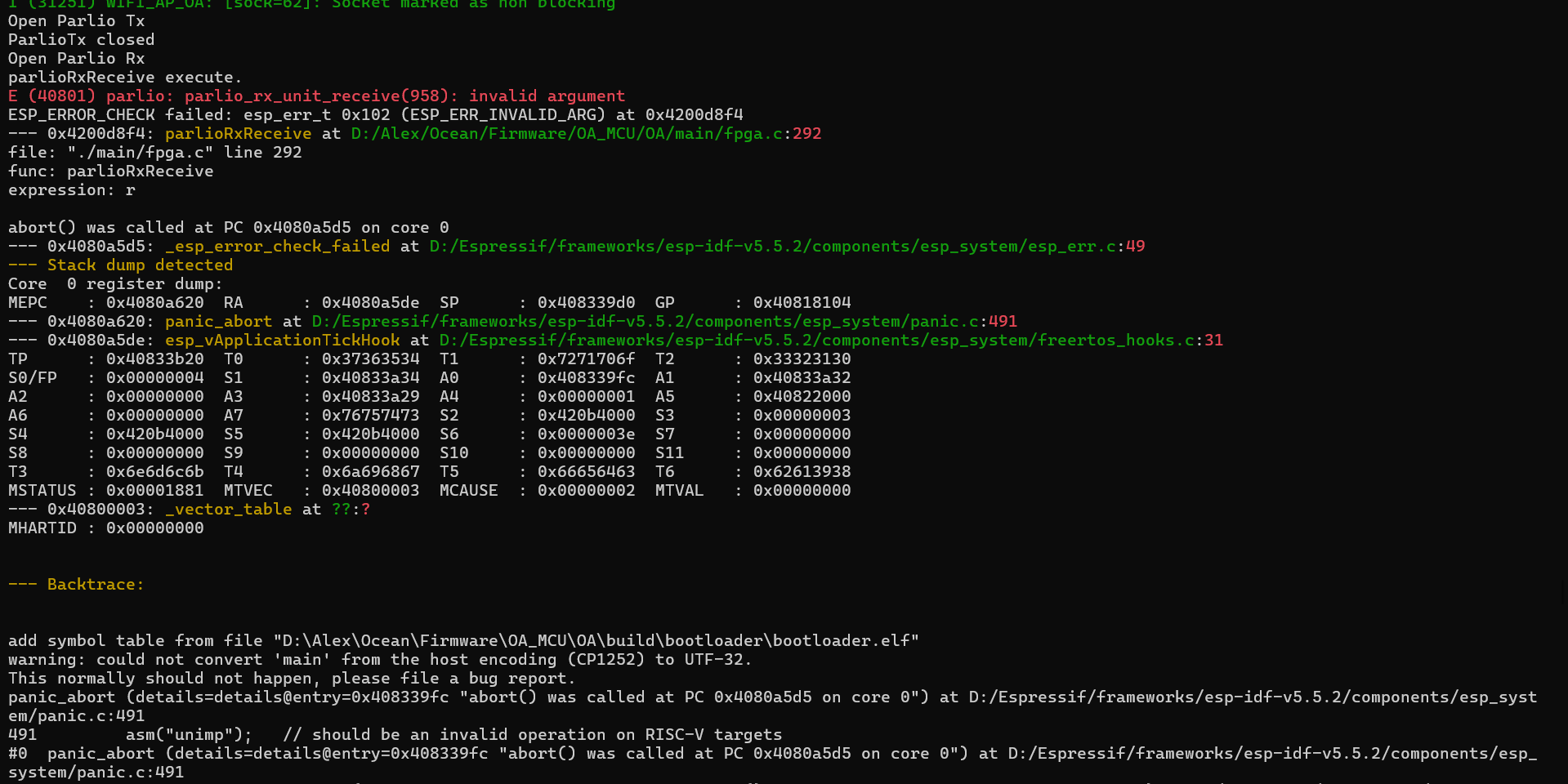

Postby karlcb » Mon Jan 26, 2026 1:33 am
ESP32-C5-WROOM-1-N8R8
ESP-IDF v5.5.2
The Parlio Tx unit working properly. But after I initialized Rx unit, and try to create a rx transaction through function: parlio_rx_unit_receive(), invalid argument error happened.
Below is relative codes, if someone from Esprissif can help to check my code and let me know what's wrong ?
Thank you in advance.
FYI, you can start from function: parlioRxReceive() (fpga.c)
fpga.c
(10.19 KiB) Downloaded 10 times

bool parlioRxReceive(uint8_t* buffer, const size_t sizeBuffer){
    if (tx.ing || rx.ing)  //正在发送或接收数据,不能发起新的接收事务
        return false;
    if (tx.unit!=NULL)
        closeParlioTx();
    if (rx.unit==NULL)
        openParlioRx();
    printf("parlioRxReceive execute.\n");
    rx.ing = true;
    // 配置 RX 单元接收参数
    rx.receiveConfig.delimiter = rx.deli;
    // 启动软帧界定符(仅软帧界定符需要)
    esp_err_t r = parlio_rx_soft_delimiter_start_stop(rx.unit, rx.deli, true);
    ESP_ERROR_CHECK(r);
    if (rx.deli==NULL)
        printf("Error: rx.deli==NULL\n");
    // 启动接收事务
    r = parlio_rx_unit_receive(rx.unit, buffer, sizeBuffer, &rx.receiveConfig);
    ESP_ERROR_CHECK(r);
    return (r==ESP_OK);
