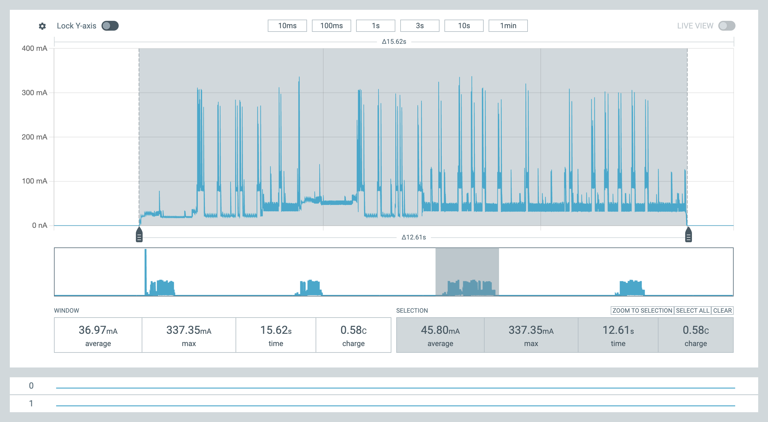

Microcontroller: ESP32-C3-MINI-1
A device we’re using collects, connects to WiFi, collects and sends sensor data of WiFi, then enters deep sleep.
After several sleep/wake cycles (between 30-600 recorded) devices, some devices stop behaving as expected and are not connecting to WiFi, potentially in a state that could be a brown-out.
I have attached an image of the current consumption during a wake-period.
Expected behaviour:
The device wakes up every hour and over the course of 9-17 seconds connects to WiFi, sends sensor data and battery level over WiFi to a back-end. The device can also be woken within the hour deep sleep duration by a button press.
Observed behaviour:
The device wakes up every hour and over the course of 9-17 seconds connects to WiFi, sends sensor data and battery level over WiFi to a back-end, however at unreliable periods does not send WiFi, and is unresponsive to button press.
Plugging the device to charge, even momentarily enables the device to behave as normal.
It is unknown at this point if the device begins its unexpected behaviour on waking, or on sleeping.
After the device is recovered, the battery appears to have discharged at a faster rate (drawing 1.8mA) than it would do in a deep-sleep state (~34uA).

Summary:
Is there anything in the following that looks like we should be implementing - such as a Watchdog that you would use?
Image of power profiling during wake, WiFi connection and data transfer period
lowvoltagehigherduration (1).png (120.52 KiB) Viewed 308 times

Not sure about this as I dont use deep sleep. But I would also disable the wifi before sleeping.
I would think that leaving it enabled, when it comes back to life again there might be some weirdness.
