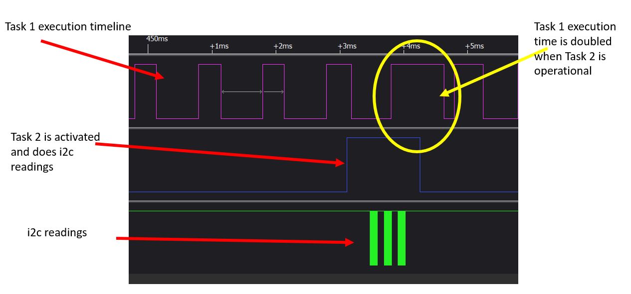

Dears, please help me to unterstand the following case (using ESP32-S3, IDF 6.0):
- I run two independend tasks, Task 1 pinned to core 1 and Task 2 pinned to core 0.
- Task 2 is activated by Task 1 with xTaskNotify and does some sensors reading by i2c with i2c_master_transmit_receive
- I control the process enabling and disabling gpio pins checking when tasks starts and finishes.
And I am struggling with unclear behavior - when Task 2 is activated execution time of Task 1 significantly increases (almost twice, please see attached image) . Task 1 has nothing to do with i2c, it is a single task running at independend core, has much higher priority and should not compete with Task 2 for any resource. But it obviously stuck somewhere for quite a long and waits until Task 2 does something, and this "something" is related to i2c operations (when I replace i2c operations at Task 2 with busy waits (ets_delay_us) all starts working normally).
Any idea what is causing the issue and if it is possible to overcome it?

Could be an interrupt thing... perhaps the I2C subsystem is initialized in a task that also runs on the same core Task 1 runs on? In that case, that core will handle the I2C interrupts, causing task1 to slow down.

thanks for replying. I also assumed that could be an interrupt thing and therefore tried to clearly separate tasks, cores and their interrupts:
- i2c is initialized from "init" task which was created pinned to core 0.
- Task 1 processes its interrupts which are created within this task (pinned to core 1).
My entire code is fairly large therefore do not hope anyone will dig into it but may be you can give any ideas how to isolate the issue. I am specifically concerned about how large this delay is, about 400us, this is enternity for S3@240MHz. Looks like Task 1 just does nothing when Task 2 reads i2c and this is weird...

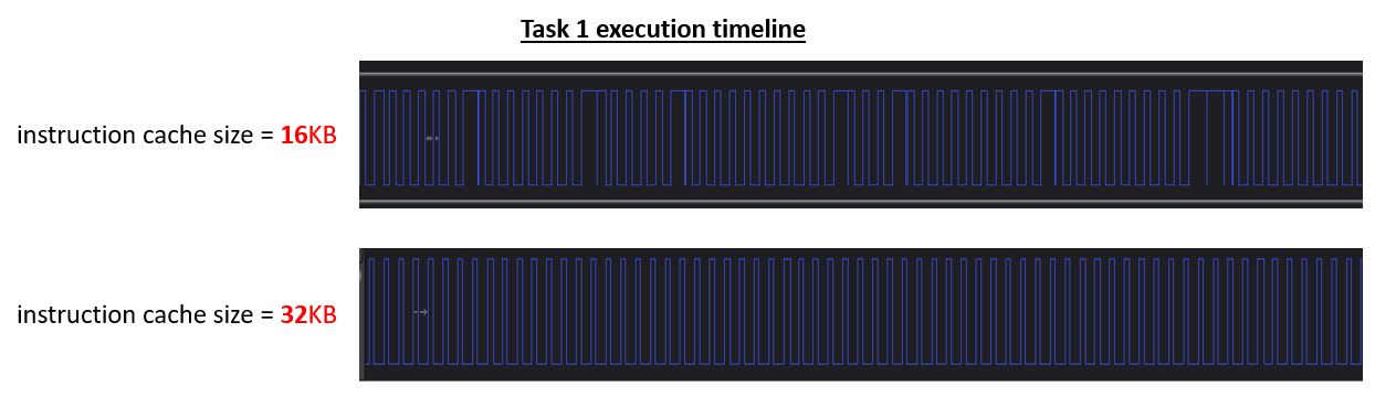

thanks to everyone who replied, you forced me to investigate in a right direction. After some tries I found Instruction cache size settings in menuconfig and changed it from default 16KB to 32KB and it started to work as expected, execution timeline of Task 1 looks now nice and regular, as should be.

Resizing the cache did not solve the problem.
My guess is still some memory corruption. By resizing the cache data in RAM moved to some other locations, and the corruption now probably happens to some other data.
