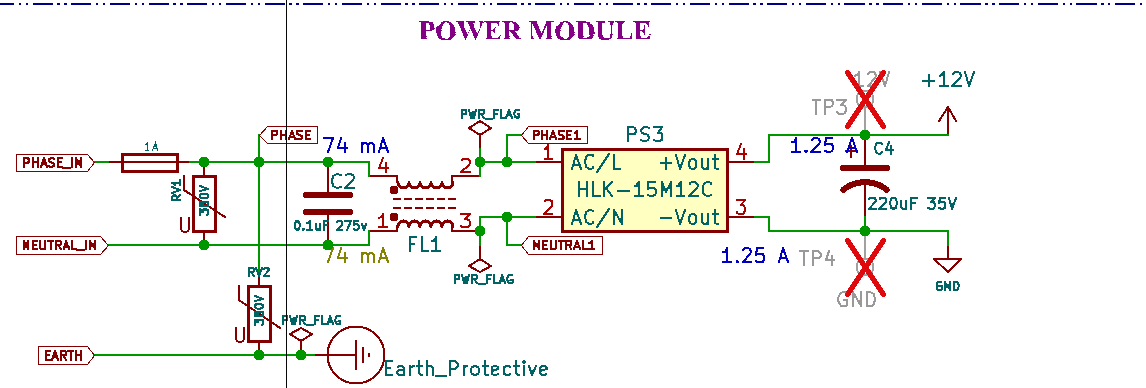

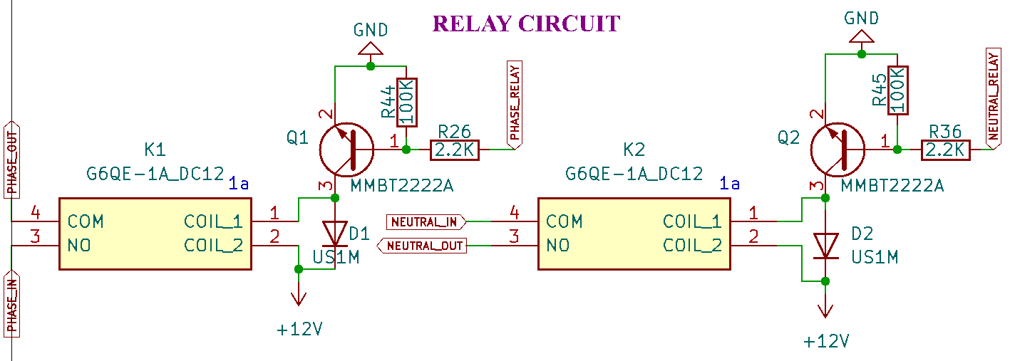

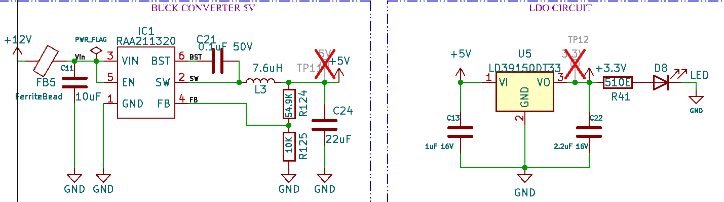

Hi everyone,
I am facing an issue with my ESP32-S3 where the controller resets exactly at the moment a relay is energized.
### 🧩 System Overview
* MCU: ESP32-S3 (Arduino IDE)
* Supply:
* 230 VAC → SMPS → 12 V DC
* 12 V → 3.3 V regulator → ESP32
* Relay:
* 12 V coil driven via transistor
* Flyback diode already placed across coil
* Application: EVSE (AC switching to EV gun)
### ⚠️ Problem Description
* ESP32 works normally
* The moment the relay turns ON → ESP32 resets
* Happens consistently
### 🔍 Observations
* MOV + EMI filter already present **inside SMPS input**
* Issue still persists
* Suspected causes:
* EMI from relay switching (AC side)
* Voltage dip on 12 V / 3.3 V rail
* Ground noise coupling
### 🧪 Tests Done
* Flyback diode across relay coil → no improvement
* Planning to check reset reason logs (brownout vs other)
* Considering adding:
* Bulk capacitor (470 µF) on 12 V rail
* Additional decoupling on 3.3 V
* MOV near relay contacts
### ❓ Questions
1. Does this look more like a **power dip (brownout)** or **EMI issue**?
2. Should I:
* Improve power supply decoupling first?
* Or focus on suppressing relay switching noise?
3. Is adding a **MOV across relay contacts (AC side)** recommended in this case?
4. Any best practices for **grounding/layout** to avoid such resets?
### 📌 Additional Notes
* I am avoiding RC snubber across AC output due to EVSE safety (leakage to gun)
* Layout may have shared ground paths between relay and MCU
Any guidance or similar experience would be very helpful.
Thanks in advance!
Regards,
Sujay Kajarekar

Re: ESP32-S3 resetting when relay turns ON (suspected EMI / power dip)
Postby Sprite » Wed Apr 29, 2026 1:57 am
A power dip should be easy to measure using an oscilloscope, I'd think.
Can you post your PCB design? It's usually pretty easy to see if that is EMC-sensitive.
