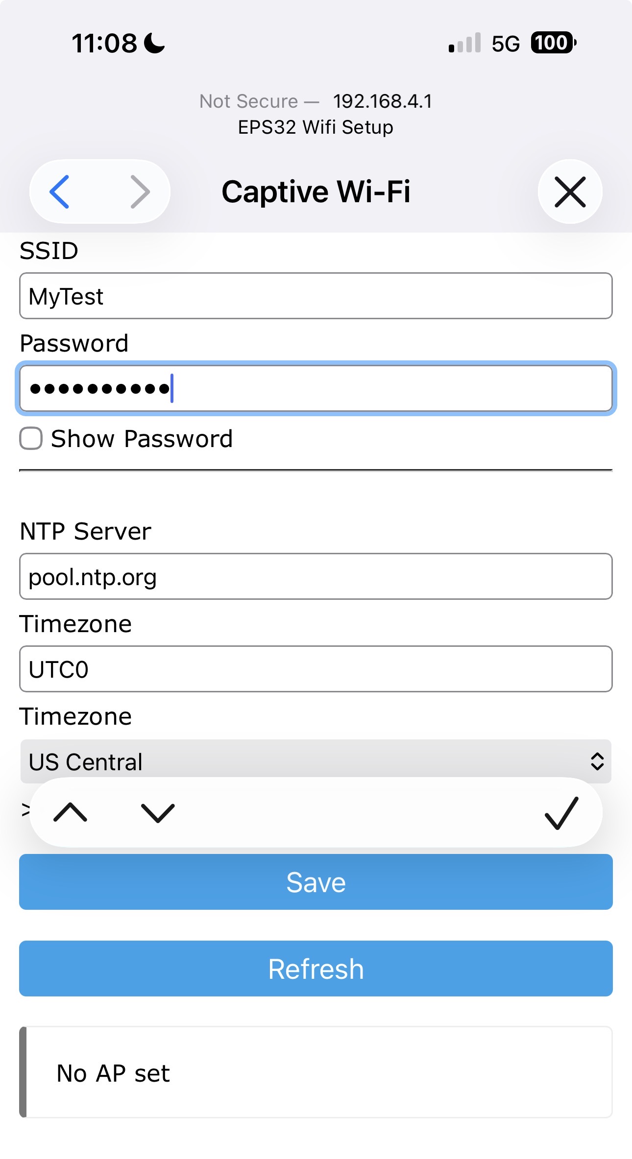

I've added the statement to bind the TZ timezone per your suggestion as shown:
WiFiManagerParameter tzParam("tz","Timezone", "UTC0", 50, tz_html);
The Captive Wifi shows 2 TimeZone selection bars
when I press save, the time zone returned is UTC0 (Which I set as the default in the bind) not the US Central one I selected
I have attached a photo of the situation
regards
regards
- Bind.jpg (225.27 KiB) Viewed 50 times
