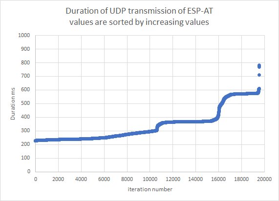

I have measured statistics of the time taken for the handshake pin to be activated. Here is the result. The graph shows the values sorted by increasing values.
One can see that about half the values range from 230 to 300 ms, then about a third of the values are remarkably constant at about 370 ms, then a new step to a value of about 570 ms, and then a few values above, including infinity.
