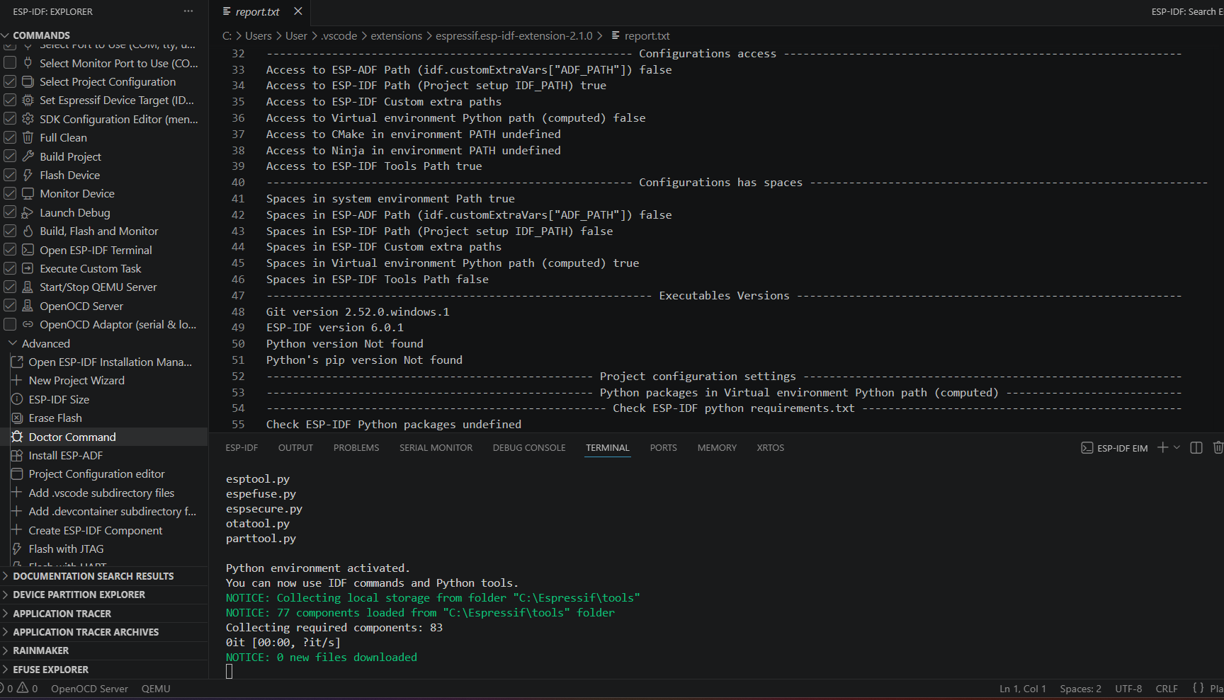

1.Hello everybody, I do not know to overcome this problem. Below is the picture of the VSCode which show in the TERMINAL : Python environment activated but from DOCTOR COMMAND : Python version Not found and Python's pip version Not found.
There is python.exe in C:\Espressif\tools\python\v6.0.1\venv but when I use NEW PROJECT WIZARD, it report that is no python.exe

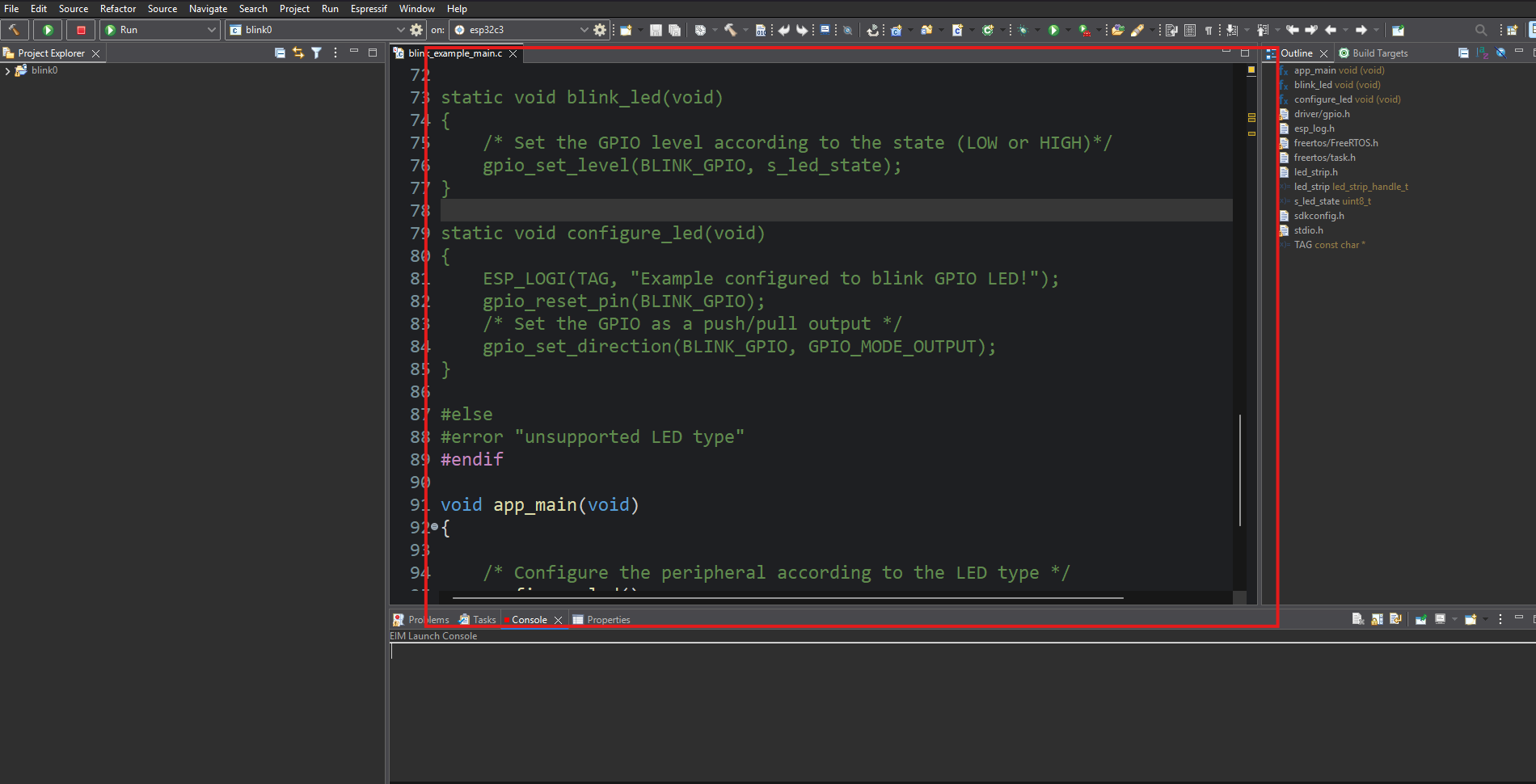

2.How to increase the font size of Espressif-Ide? From the picture attached, only in the red area the font can be increased whereas I want all.

Hi @MohdRais
Seems that your configuration in the extension is not correct. Because I can't the see actual settings value I don't know what is wrong but the virtual python path says it has spaces and can't be found.
Which extension version, how do you install ESP-IDF ? (using EIM or how ?)
Please share more details or open a GitHub issue in our repository https://github.com/espressif/vscode-esp-idf-extension

Postby MohdRais » Fri Jun 19, 2026 8:17 am
Hello, I am using Window Pro 11 V25H2, IDF-V6.0.1 and IEM V0.13.1.

Postby MohdRais » Fri Jun 19, 2026 8:21 am
HI @bignacio , I am using Window Pro 11, IDF-V6.0.1 and IEM V0.13.1
