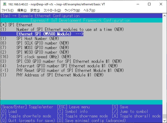

I'm trying to interface an ESP32C6 (specifically ESP32-C6-Zero → https://docs.waveshare.com/ESP32-C6-Zero) with a W5500 breakout module. This is my pin configuration
MISO → GP4 (defined as ETH_MISO)
MOSI → GP22 (defined as ETH_MOSI)
SCLK → GP21 (defined as ETH_SCLK)
CSn → GP14 (defined as ETH_CSn)
INT → GP18 (defined as ETH_INT)
RST → GP0 (defined as ETH_RST)

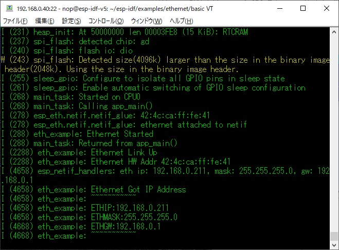

I can indeed see the MAC address show up in my routers log but no address is ever assigned. It looks like initialisation is OK but no address is ever assigned to the interface and the logs pretty much stop here
I (286) SPI: SPI bus initialized
I (286) ETH: W5500 MAC initialised
I (286) ETH: W5500 PHY initialised
I (306) ETH: W5500 ETH driver initialised
I (306) esp_eth.netif.netif_glue: 02:29:11:52:33:44
I (306) esp_eth.netif.netif_glue: ethernet attached to netif
I (316) eth_basic_example: Ethernet Started
I (2316) eth_basic_example: Ethernet Link Up
