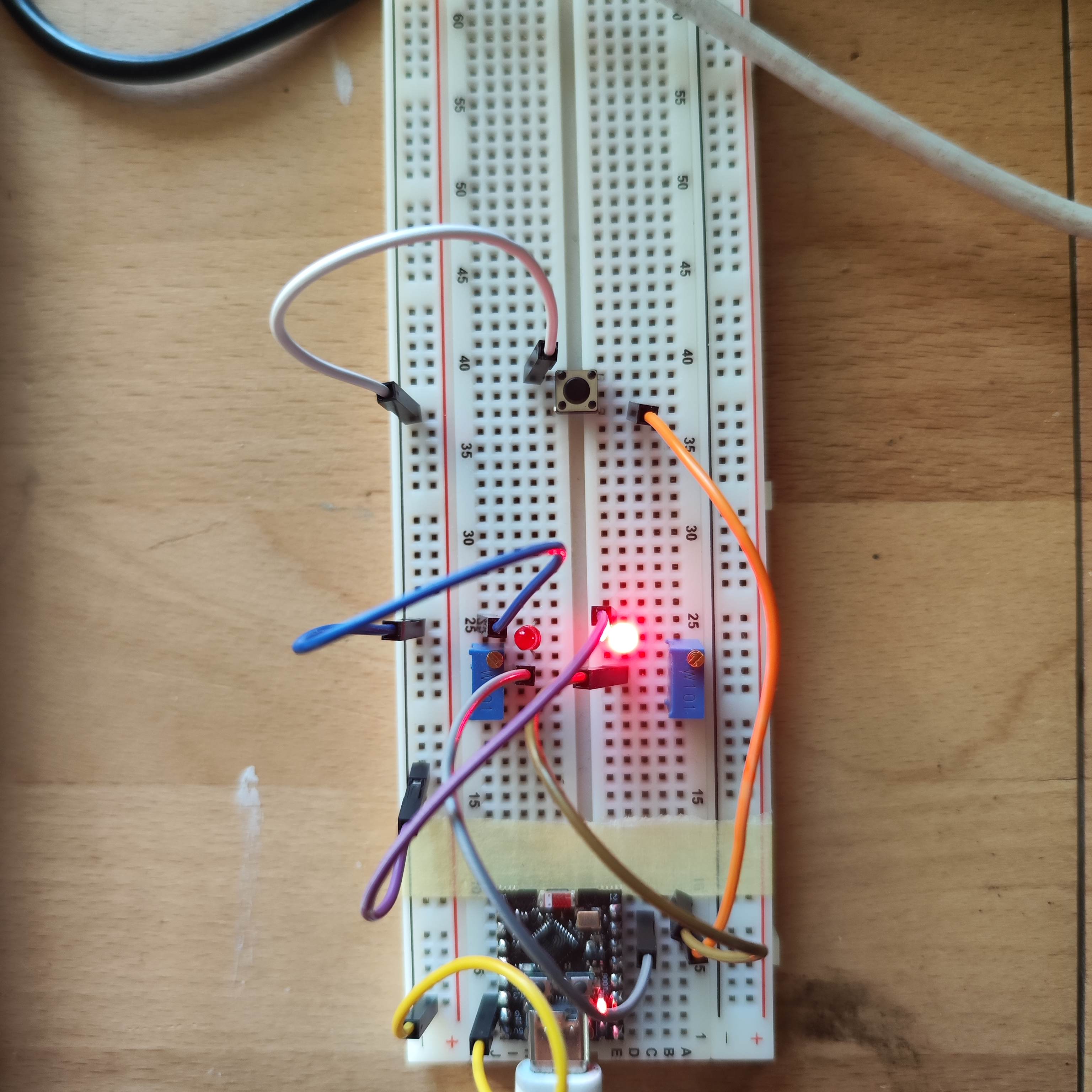

Postby TryThings » Tue Jul 07, 2026 6:31 pm
I know I've used some overkill features like interrupts, but I wanted to experiment.
Initially I hoped that the glitch filter would help me against the bounce of my button, but in the end I had to find an additional workaround, otherwise it often happened that the trigger would fire twice.
The purpose of this project is to explore different features of the ESP32 combined with Espressif's IDE to have two LEDs blink alternatively each second.
So far it works good, except for some occasional double triggers even the DEBOUNCE_MS value set to 50, 70 or 150ms.
I'll probably have to set it even higher, but one day I'd like to find a better solution for this issue, maybe by dropping any attempt to tie interrupts to physical input and just use a while() cycle.
Here is the main code:

Postby Sprite » Tue Jul 07, 2026 11:54 pm
- For things that you'd expect to always succeed (outside of a bug in the code) you can also use assert() or ESP_CHECK() to test it. It's shorter than a manual if(fail) printf("failed") solution.
- gpio_reset_pin is superfluous, gpio_config already has the same functionality under the hood (iirc gpio_reset_pin calls gpio_config with some default values)
- You're enabling the interrupt before attaching the ISR service. That means there's a small period of time where pressing the button will lead to a panic (ISR called but none installed). You probably want to switch those statements around.
- I did not know the compound literal trick. Gotta remember that, that's useful.
- You can use #ifdef HEADER_NAME_H guards, but nowaday it's more common to replace those #IFDEF/#DEFINE/#ENDIF lines with a single '#pragma once'. No namespace collisions possible and it's a lot shorter.
- Your header is a mess. General rule of thumb: Never put variable declarations in there unless they're 'extern' (and if you feel the need to do that, think really really hard if it's needed), never put function bodies in there unless they're 'static' (and again, think really hard if you need to do that). Reason is that multiple C files can include the same H file, and remember: including in C means the preprocessor effectively copy-pastes the content of the H file into the C file. That means you'll have multiple variables or functions with the same name, making the linker fail.
This is personal, but I'd take a look at your naming scheme as well. E.g. you're calling something BUTTON. It's a definition/constant, so capitals are traditional, that's good. But what does BUTTON contain? As it is right now, it seems to contain the physical button. Probably better to be more precise, and call it e.g. BUTTON_GPIO_NO: it contains the number of the GPIO the button is connected to. You then seem to take the fact that BUTTON is written in all caps and propagate that to e.g. BUTTON_interrupt_function. That has nothing to do with the fact that BUTTON is a constant, though, so there's no need to write that in caps. You seem to a use lower-case underscore style for functions, so that would be button_interrupt_function instead (and notice how you are being properly descriptive in what it is in this name: the function called on the interrupt for the button)
Your C file generally is decent, but I would read up a bit more on what headers (.h files) do if I were you. They're the interfaces to your code and generally only contain the function declarations (not the definitions, in other words, there's no actual code in your header file) as well as any type definitions (structs, typedefs etc) needed to interface with that code, and if you really need to, also extern variable declarations. There are exceptions (e.g. static inline functions for quick accessors or utility functions) but if you're a beginner I'd forget those exist for now.

Hello, thank you very much for the detailed feedback, I'm working to implement all the improvements you've recommended.
In the meantime, I'm having issues with the #define macros, since I've split
BlinkCycleFunctions.c
and
BlinkCycleFunctions.h
but now my main.c doesn't recognize stuff like BUTTON, LED1, LED2 etc. anymore.
What should I do? re-#define-ing all these also in main.c seems not the right way.
