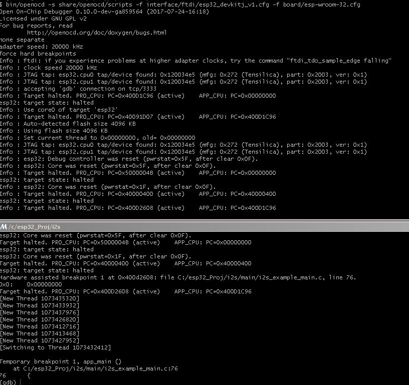

I recently got a new WROVER Dev board. I use one of the examples to get started with Eclipse on windows, following the online instructions. I did all steps as described, and I can build and flash the kit both on msys32 command line and Eclipse.

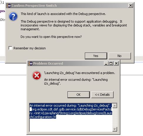

Problem starts with debugging. I Use the USB embedded debugger option. I Manage to connect on debugger over the command line and step/add breakpoint/ etc just fine, again as described on the online instructions (http://esp-idf.readthedocs.io/en/latest ... er-eclipse). When I try the same instructions for windows / Eclipse, I get an error immmidiatelly, that I can't tackle. In short the error is this:
An internal error occurred during: "Launching i2s_debug".
org.eclipse.cdt.dsf.gdb.service.GdbDebugServicesFactory.<init>(Ljava/lang/String;Lorg/eclipse/debug/core/ILaunchConfiguration;)V
Note that I am not an advanced user of Eclipse, and also not a great fan, but my first interest is the coding, and I want to get fast on the development of my firmware on ESP32. I dont wish to debug the tools to do that, I just want to use them.
Consider me a noob in terms of using OpenOCD and Eclipse, who faces them as toolsl made by someone who knows how they work.
I have attached feww screenshots of commandline success and Eclipse failure if it would help anyone.
cmd ok
screenshot of error

Hi, long time I haven't checked all this, sorry for a late reply.
I haven't had any serious progress on this. Sometimes this procedure described in the tutorials for debugging in Eclipse, works, some times it fails. If I give it a number of tries, I usually get it working, but it is not as stable as I would want it to be. I also bought a OLIMEX OCD-JTAG, this was even worse. About the Olimex dongle, maybe its also my fault, since I am not an expert in configuring and debugging the OCD tools. But still all solutions for onboard debugging seem weak. I hope & believe they will improve this part too.

Hey there. I've got my hands on ESP-WROVER-KIT and I've got the debugger working. I'll give you some tips!!
1. Connect the jumpers needed for JTAG below the board.
2. Check that you haven't assigned any JTAG pin in GPIO driver or anything else (happened yesterday and lost about 20minutes trying to figure it out!)
3. Firstly you run OpenOCD and secondly the x-tensa debugger. Follow the steps here "Run openOCD" and here Using Debugger and you will be fine.
Try using it in blink example at first in order to check if it works. I hope this will help you.
Regards, Kostas

FWIW: This means a physical problem in the communication between the JTAG adapter you have and the ESP32. As Kostas already said, checking your connections (as well as Vtar, if your JTAG board needs it) and seeing if your ESP32 program reconfigures the JTAG GPIOs are the first thing to do here.

I found out what was causing the issue with the "all ones" problem... disappointing discovery! My project uses SPI and the GPIO 12->14 are common for JTAG, so this was stopping the JTAG. Once I disconnected everything from these pins, I came back to my old situation.
