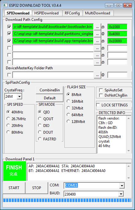

I have bought a development board from espressif (ESP32_Core_board_v2). I have installed the SDK and ESP-IDF framework.
I follow all the guides and I compiled the esp-idf-template project (from github). Then I downloaded the firmware using "ESP download tool v3.4.4" (see the screenshot attached).
However the device seems blocked and loop this informations:

The ESP-WROOM32 module on the Core Boards currently only supports DIO flash mode. Change the flash mode in "make menuconfig" under "Serial Flasher Config" from QIO to DIO, run make tho rebuild, then re-flash. If using the GUI flasher tool, this option may also need to be changed from QIO to DIO.
(Note that in very recent esp-idf master branch versions, the partition table offset has also changed from 0x4000 to 0x8000. So if you get a subsequent error about partition table, try changing this value in the GUI flasher. If you use the command line "make flash" then it will be changed automatically.)

I changed the SPI MODE to DIO and setup the partition table to 0x8000 and it works.
