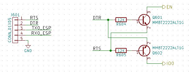

I have a download problem with a ESP32 WROOM. l connects well but seems not to detect FLASH. Here is the error message.
I check everything, change the ESP but still the same.
Do you have an idea.
thank you in advance

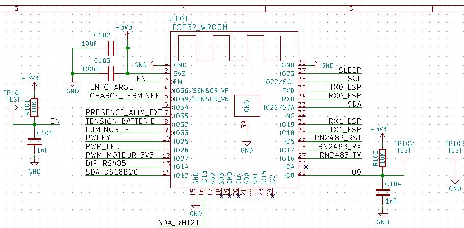

What hardware (development board, etc) is connected to the WROOM? Is it possible something is connected to the SPI flash GPIOs of the WROOM module (GPIOs 6-11 inclusive)?

Hello and thank you for your answer.
No nothing is connected to GPIO6-> GPIO11.
see diagram. I do not know what to do anymore.
Thanks for your help

Postby Beroy40 » Mon Mar 26, 2018 6:49 am
Here is the part to lower the code.

If there are no shorts or other assembly/soldering problems on those same pins on the board then it's possible your WROOM has a faulty flash chip.

boot: 0x33 (SPI_FAST_FLASH_BOOT)
This means gpio12 is pulled high at boot (1-wire/i2c pull-up) selecting 1.8v flash voltage which is not correct for wroom32. Gpio12 should be pulled low at boot.

THANK YOU MUCH, you're right.
I am really stupid because I had read that on the datasheet but I had not made the connection between MTDI and GPIO12.
Everything is working properly!
