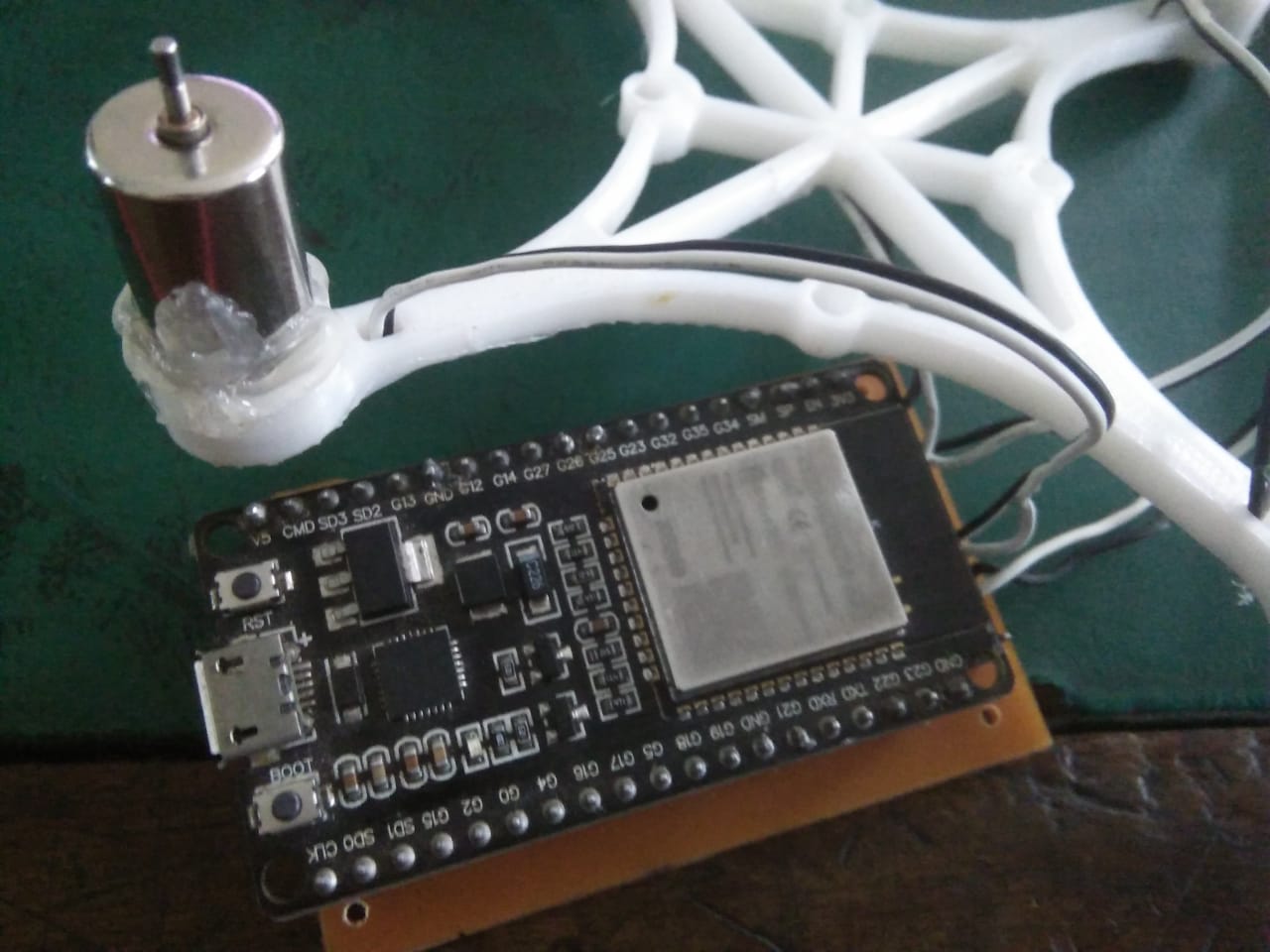

saumik
Joined: Mon Dec 09, 2024 8:25 am
Re: Esp32 Led won't stop blinking if external power are used
Postby saumik » Mon Dec 09, 2024 8:35 am
But all other GND are not shorted with this pin. I was trying to control brushed motor using esp32 and a03400. whenever i am checking the voltage connecting it to usb it is all good, but powering with 3.7 v battery and booster it is not working also it is is continuously blinking. What should i do?
WhatsApp Image 2024-12-09 at 14.33.29_1ee1e3d7.jpg (99.07 KiB) Viewed 5638 times
