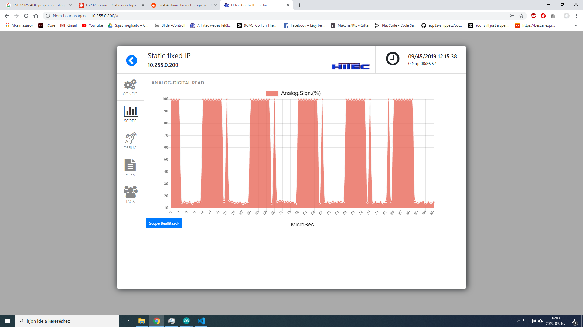

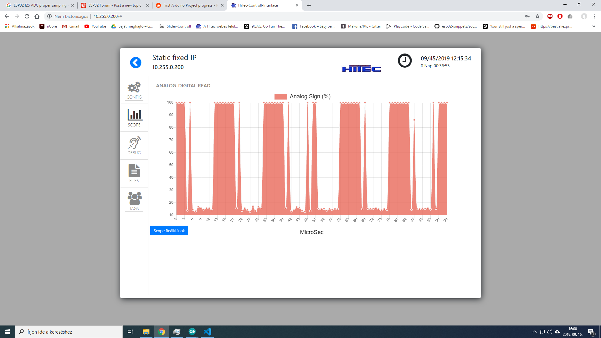

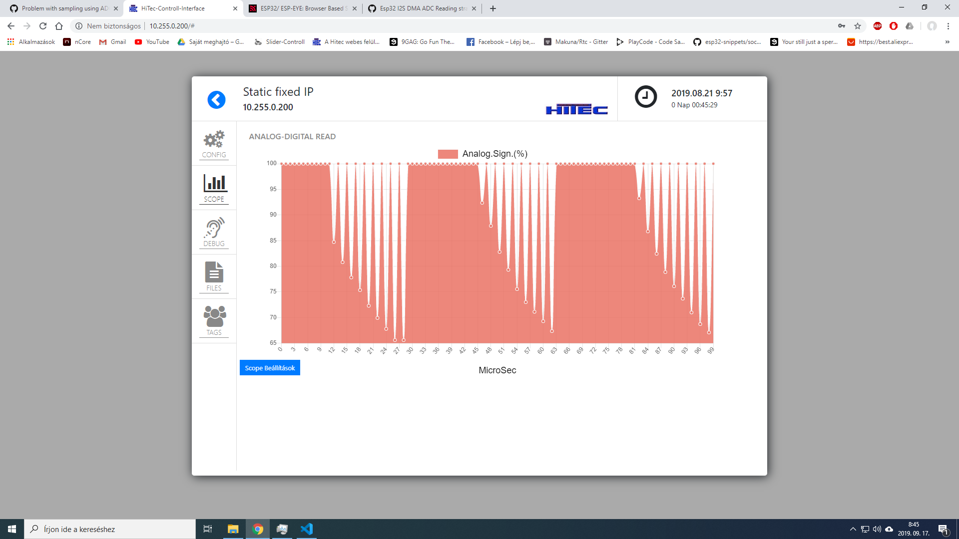

I have got the same problem.
No matter what, i measure the same signal on all the channels of the ADC1 just with more "noise" when i config the ADC to just one channel.These signals are coming from a signal generator with 4Khz. I measure it with 8Mhz.
.sample_rate = 80000
i2s_set_adc_mode(ADC_UNIT_1, ADC1_CHANNEL_0);
ADC1_Channel_0
Képernyőfelvétel (16).png (202.79 KiB) Viewed 17311 times
ADC1_Channel_3
Képernyőfelvétel (14).png (192.29 KiB) Viewed 17311 times
ADC1_Channel_4
Képernyőfelvétel (13).png (196.34 KiB) Viewed 17311 times
