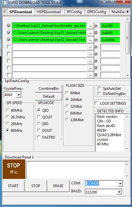

1. Develop the code using Arduino
2.Change output format(.ino) into (.bin).
3.select esp32 flash download tool shown in image below.
4.upload the code,it will loading then finally it shows "FINISH".
5.After then reset the module it shows the error
rst:0x1 (POWERON_RESET),boot:0x16 (SPI_FAST_FLASH_BOOT)
flash read err, 1000
Falling back to built-in command interpreter.
OK
6.how to overcome from this.please give suggestion for flash download tool for esp32 using .bin file.
7.whether the tool is also used for production level...

The "flash read err, 1000" indicates that the ESP32 didn't find a bootloader binary at offset 0x1000.
If using Arduino binaries, you need to flash:
  • Either ./tools/sdk/bin/bootloader_qio.bin or ./tools/sdk/bin/bootloader.bin (for QIO vs DIO mode) at offset 0x1000
  • ./tools/partitions/default.bin at offset 0x8000
  • Your app's .bin at offset 0x10000
Another way to find this information is to go to Arduino Preferences and enable "Verbose Upload". In the Arduino console it should show the full command being sent to esptool.py (the command line version of the Flash Download Tool), with filenames and offsets.

I test as per your reference.
Flash -QIO - bootloader_qio.bin for 0x1000
partitions -> default.bin for 0x8000
.bin of source for 0x10000

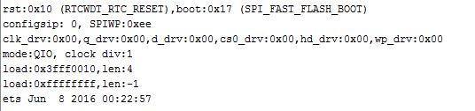

After programming it show
kindly give any other solution ...

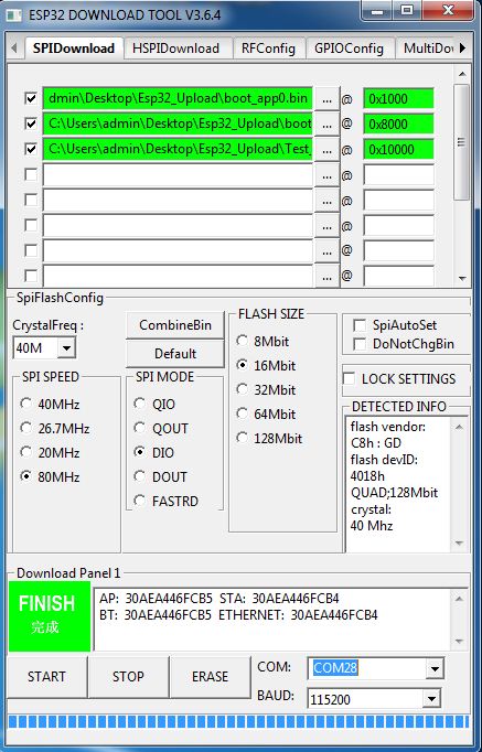

Re: ESP32 Flash Download Tool produces "flash read err, 1000" on boot
Posted: Mon May 14, 2018 8:15 am
by Angus
Try changing the "SPI Mode" in the UI from QIO to DIO. The bootloader (bootloader_qio.bin) will be loaded in DIO mode and then it enables QIO mode. This how Arduino ESP32 and ESP-IDF both enable QIO mode.
If this doesn't work, QIO may not be compatible at all. Try flashing bootloader.bin instead (in DIO mode).

Hi Angus,
I change the SPI mode to DIO for bootloader_qio.bin...
After reset the device, it shows that ....
and also i tried bootloader.bin in DIO mode ...
rst:0x1 (POWERON_RESET),boot:0x17 (SPI_FAST_FLASH_BOOT)
configsip: 0, SPIWP:0xee
mode:DIO, clock div:1
load:0x3fff0010,len:4
load:0x3fff0014,len:708
load:0x40078000,len:0
load:0x40078000,len:12168
entry 0x40078a68
user code done
finally it shows user code done...i think...the code is loaded...but it will needs any configurations?
Posted: Tue May 15, 2018 7:22 am
by Angus
This looks like it's loading the bootloader binary but then it's exiting. I'm not sure why this would be.
Check the Verbose Upload output in Arduino (see a couple of posts back) and make sure the files & offsets you're flashing match the files & offsets given there.
