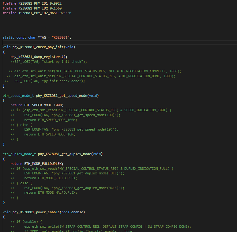

Alright, I got everything working. However it is all done in the ESP-idf from Espressif (and not the Arduino core).
Basically i copied the example of the LAN8720 and removed all the setup. (so no internal registers got changed, all stayed on default), and changed all the names to from LAN870 to KSZ8081
Then i changed the PHY-ID to the one specified in the datasheet.
I know this is a dirty workaround. but i had no luck/time to get it done in a nicer way.
The RMII bus still gives an interrupt when the link is up.
Everything works fine, I did not have a single problem regarding Ethernet connection.
I added a image for a more clear picture. Hope i could help anyone out!

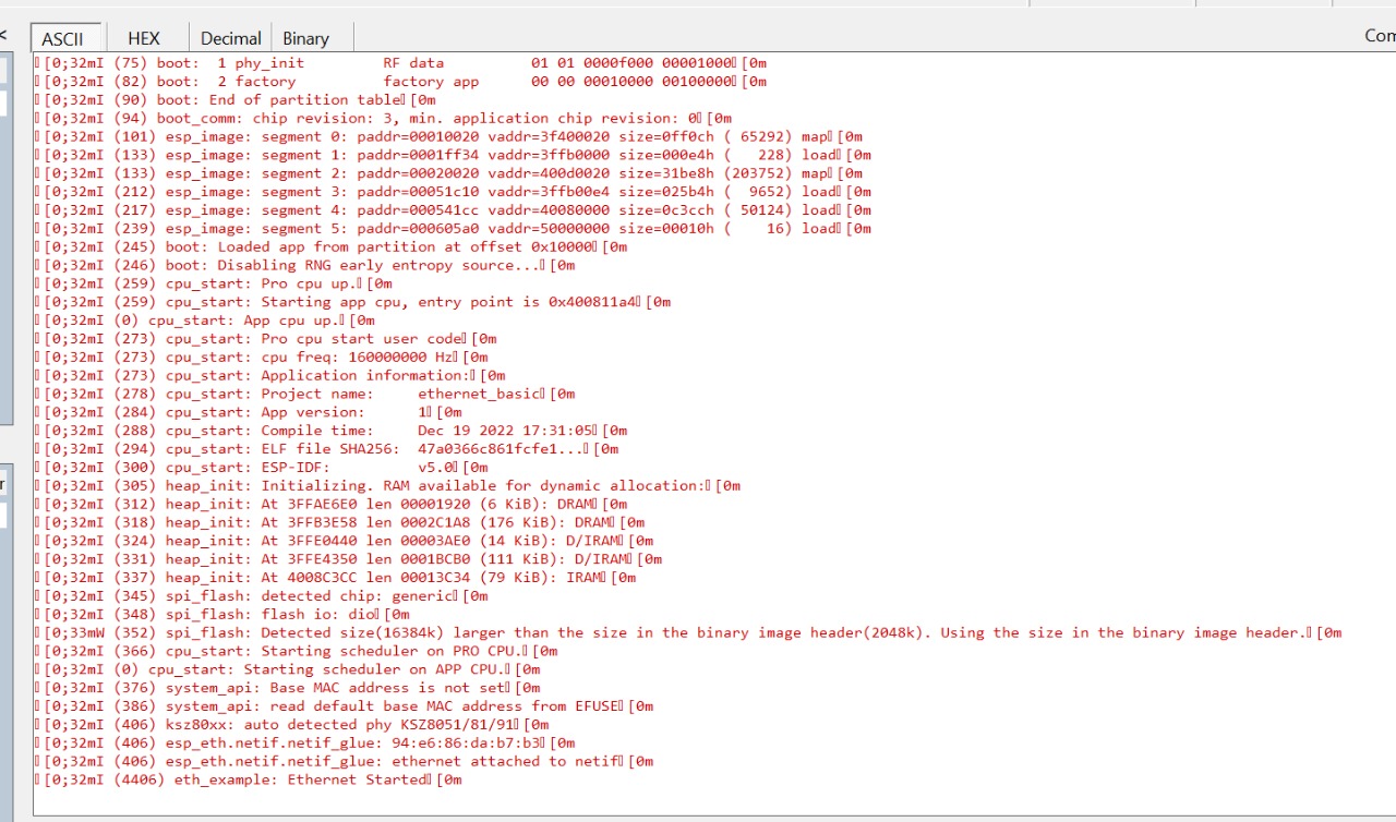

I am using ESP-IDF and I can see now the chip selection (KSZ80xx) is given in the ethernet example code. I have tried to configure the ethernet example for KSZ8081 but have not been able to succeed.
I am getting "Ethernet Started" but link is not getting up and getting IP address.
Please help me to configure the project KSZ8081 till I am getting IP address and network connectivity.
Thank you!
Thank you!
