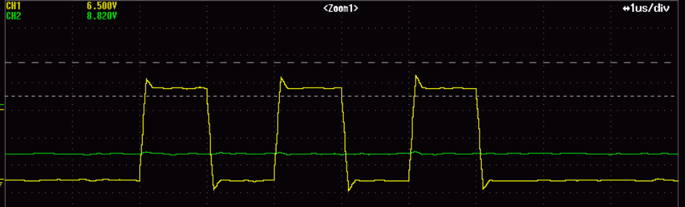

Below is a picture of the trace at 1Mbps. What I have noticed however is if I send 1400 bytes the uart_read_bytes returns a value in the range of 1390.
If I send 600 bytes I get a len of approx 596.
I use the following to read those bytes.
int len = uart_read_bytes(uart_num, (uint8_t *)&recvfrmMicro[0], sizeof(recvfrmMicro), 10 / portTICK_RATE_MS);
I suspect that the ISR cannot keep up.
Is it possible to use DMA on the UART?
EDIT:
The reason I believe the interrupt service routine can't keep up is that at at 500kbps the len equals what was sent.
Regards

Re: UART Communication problems at 921600
Glad you solved the framing issue. What was the root cause?
We run an automated test on our AT command firmware (which uses the UART driver) to ensure no loss of data at 2Mbps. So in theory the UART driver can keep up. Is it possible there's another task or a lot of interrupt activity on the same CPU as the UART receive, which may be starving it of resources?
EDIT: Did you call uart_driver_install()? What rx buffer size was specified?
There's hardware support for a UART DMA mode ("UHCI") but unfortunately the only implementation is currently for Bluetooth HCI.I think the root cause is as you mentioned; I the interrupts for the send and receive socket server task is most probably on the same CPU. As a result slowing the baud rate worked.
I've had a similar issue on our main processor before and we used DMA instead of an interrupt driven driver to solve it.
That's why I'm interested to find out if DMA is available on the UART?
It depends on how fast you think your task can call uart_read_bytes(). The ISR will fill the buffer and uart_read_bytes() will empty it.I did call the uart_driver_install(). The RX buffer size was set at 4096.
Do you have a recommended size for that speed (1Mbps)?
In other words: If the ISR is delayed, the 128 byte hardware FIFO overflows. If the task is delayed, the RX buffer overflows. If you're losing bytes in a 1310 byte transfer with a 4096 byte buffer then the problem is in the ISR, though.
You can use xTaskCreatePinnedToCore() - see https://espressif-docs.readthedocs-host ... k-creationI'm not 100% sure how to allocate the tasks to the different processors yet.
If you create a task pinned to CPU 1, and then call uart_driver_install() from this task, then both the ISR and the task will be on CPU 1 and should be isolated from WiFi activity.
