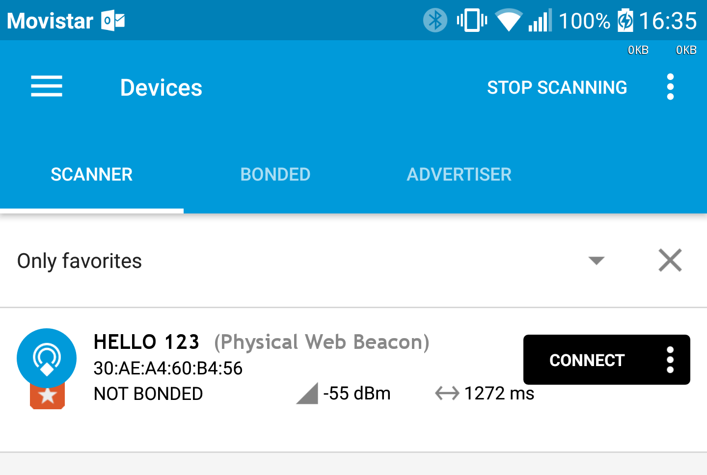

Hello everyone, I'm having an issue when setting a Beacon with both advertising packet and scan response.
Here is my code.

Here you can see the advertising parameters with minimum and maximum values I found in one example.
// data advertising parameters.
// TODO error with min. and max
static esp_ble_adv_params_t ble_adv_params = {
		.adv_int_min = 32,
		.adv_int_max = 32,
		.adv_type = ADV_TYPE_NONCONN_IND,
		.own_addr_type  = BLE_ADDR_TYPE_PUBLIC,
		.channel_map = ADV_CHNL_ALL,
		.adv_filter_policy  = ADV_FILTER_ALLOW_SCAN_ANY_CON_ANY,

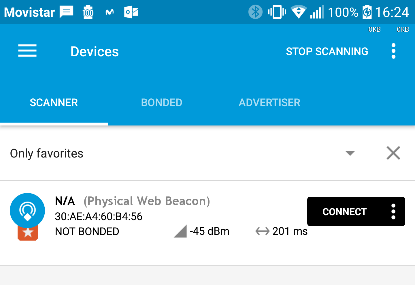

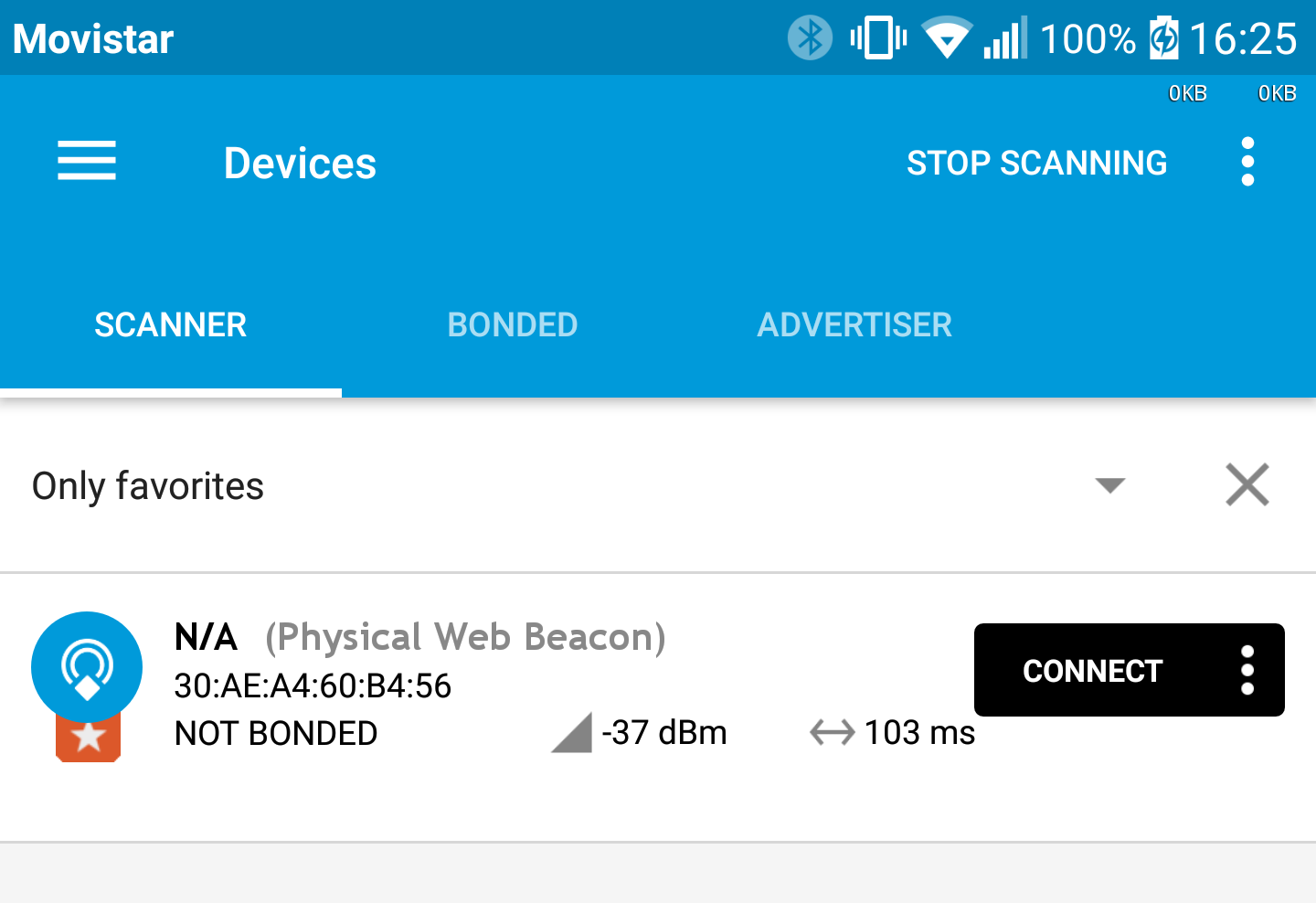

and here is the output in NRF Connect.
As you can see, the advertising interval is wrong, not 20ms, which I clarify I'm not using, but rather is the default interval shown in ble_gap_api 1,2 seconds.
typedef struct {
    uint16_t                adv_int_min;        /*!< Minimum advertising interval for
                                                  undirected and low duty cycle directed advertising.
                                                  Range: 0x0020 to 0x4000 Default: N = 0x0800 (1.28 second)
                                                  Time = N * 0.625 msec Time Range: 20 ms to 10.24 sec */
    uint16_t                adv_int_max;        /*!< Maximum advertising interval for
                                                  Time = N * 0.625 msec Time Range: 20 ms to 10.24 sec Advertising max interval */
    esp_ble_adv_type_t      adv_type;           /*!< Advertising type */
    esp_ble_addr_type_t     own_addr_type;      /*!< Owner bluetooth device address type */
    esp_bd_addr_t           peer_addr;          /*!< Peer device bluetooth device address */
    esp_ble_addr_type_t     peer_addr_type;     /*!< Peer device bluetooth device address type */
    esp_ble_adv_channel_t   channel_map;        /*!< Advertising channel map */
    esp_ble_adv_filter_t    adv_filter_policy;  /*!< Advertising filter policy */
} esp_ble_adv_params_t;
Now, looking for advertising normative in Apple iBeacon (https://developer.apple.com/ibeacon/) which is 100ms and Goggle Eddystone 200ms, or actually any value different from 32 shows the output of the advertising packet but not the scan response packet.
min 160, max 160 (100ms)
min 320, max 320 (200ms)
I appreciate any help you can provide me. feel free to ask any question.
