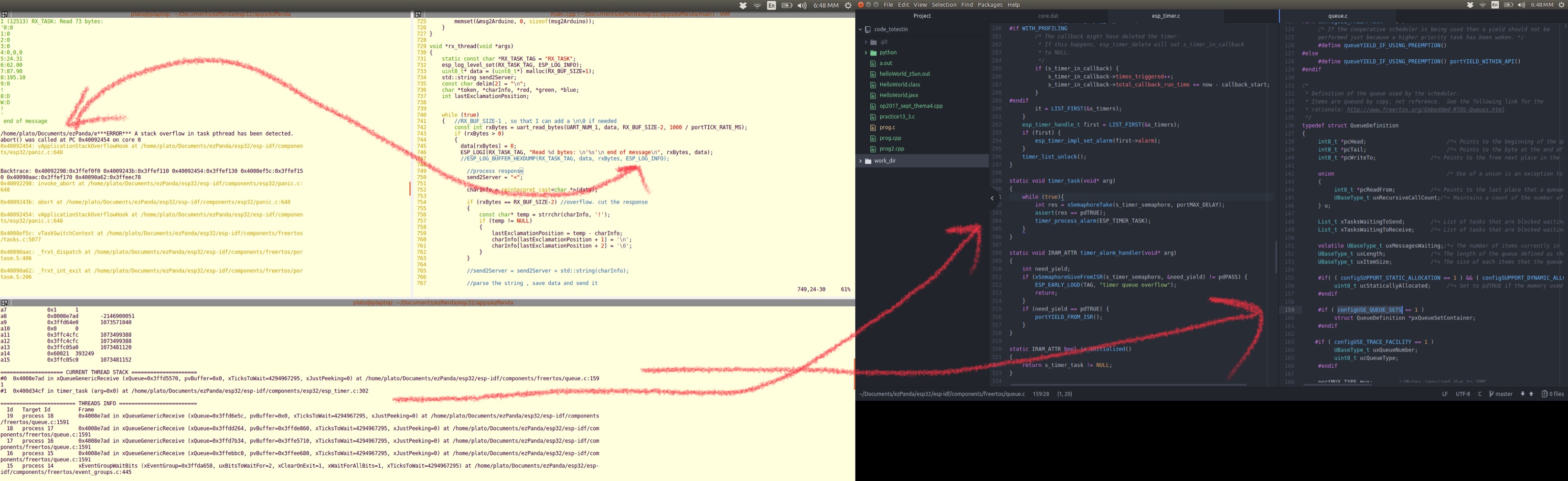

Help ! This error is non-deterministic. Sometimes it happens, sometimes not. When it happens, it seems to be right after I read something from the UART and always in the first seconds of the program execution.
You will find my snapshot attachment very descriptive.
The truth is that i surely put too much weight on my esp32 : I use 2 sockets, one of which runs non stop, the bluetooth, a hardware timer which blinks a led, UART communication.
All of these interact through freeRTOS Tasks (using xEventGroup, xQueue) but also through classic pthreads.
UART read (which is where the exception seems to happen) is run by a pthread.
I try to find where exactly in my code did the exception happen, but I cannot.
I checked the CORE DUMP and through menuconfig I demanded to print via UART all messages (Info, Errors, ... everything). But still, I cannot find nothing that determines where the error actually happened. I guess that's because of the errors nature (stack overflow) but again , why is it sometimes happens and sometimes not?
Anyway, if stack is not enough , what do you propose me to do ? I already tried to increase Main Task stack size from 3584 to 7168(since pthreads live inside mother main task) but this didn't help.

In your code, are you creating any additional tasks/threads? If so, what stack size are you allocating and/or what statements are you calling to created those tasks/threads?

If its really pthread stack error then you have in menuconfig settings to change pthread stack size. By default its 3kB.

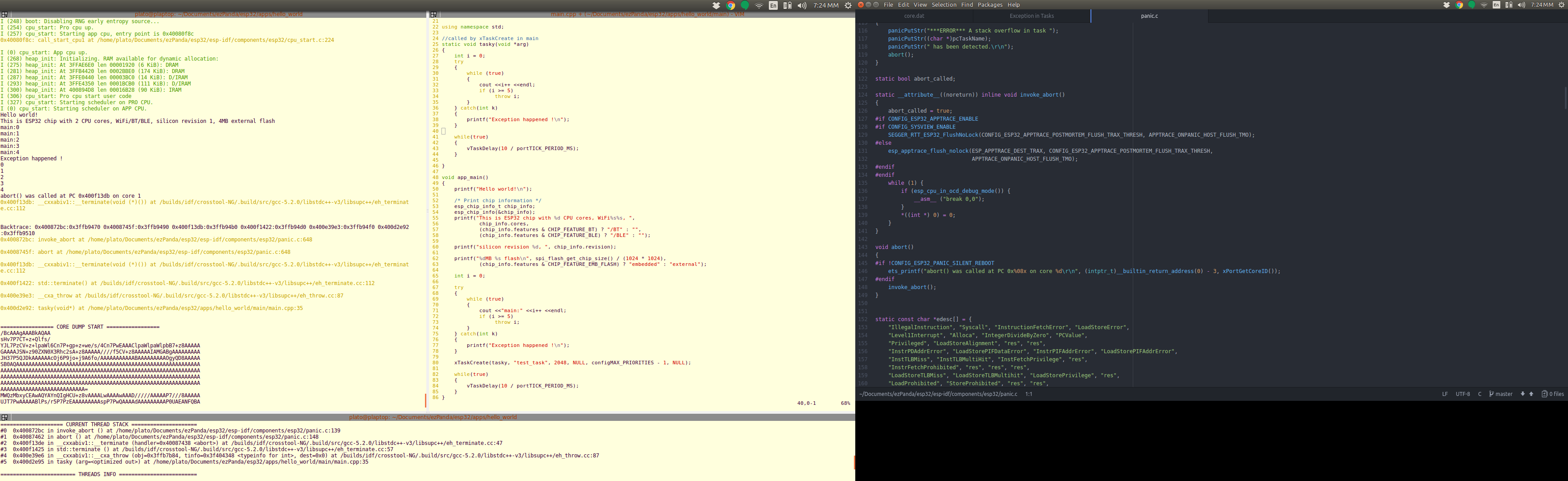

As far as C++ exceptions are concerned, are you sure they do work? I mean, in my system they do compile but when it comes to the point of getting them thrown, the core dumps.
I leave a screenshot here, of my code and the errors I am getting for the above issue.
As you can see exception in main thread happens naturally.
C++ exception support is turned off by default in menuconfig, which means that throwing an exception immediately calls std::terminate which calls abort() (as shown in the log).
This is the item which must be enabled to use C++ exceptions:
http://esp-idf.readthedocs.io/en/latest ... EXCEPTIONS
Once C++ exception support is enabled, you should be able to throw/catch exceptions from any RTOS task or pthread.
Note that turning on C++ exception support will increase the overall stack usage of any C++ code, so if a 3KB pthread stack size was already borderline then it will definitely be too small with exception support enabled. You can increase the default size in menuconfig, or switch to creating tasks with FreeRTOS APIs (and explicit stack size in the function call), or you can call esp_pthread_set_cfg() as mentioned by kolban above.
