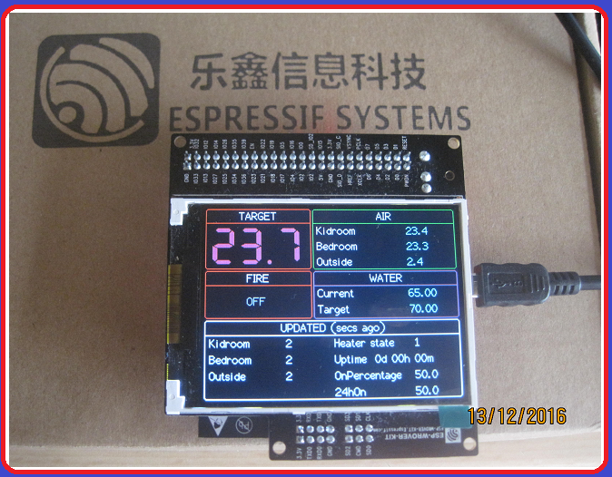

Here's an example code for ILI9341 using the adafruit library & Sermus' compile of ILI9341 on ESP8266 found here : https://github.com/Sermus/ESP8266_Adafruit_ILI9341.
It's now using a finished SPI driver & it can be used for building a simple UI on the screen. It's based on the esp-idf official sdk, and you can directly run a make flash in the example folder attached with this reply. It's yet to be merged, hence the attachment.

Hi Nilay,
Thank you for your sharing.
I download this firmware to ESP_wrover, but no response. Is it supposed to run on ESP_wrover? Or I should use another board?

hi ESP_Greg,
cause i get last days one of the fantastic ESP-WRover Kits from Santa Claus
https://twitter.com/eMbeddedHome/status ... 8278486016
( test on DevKitC )
https://twitter.com/eMbeddedHome/status ... 6283441152
i can test and help you ;-) ( thanks @espressif )
no sure what fail in your ESP_WRover ;-)
first, see the shema of the ESP_WRover Board
then change the code in the Header File "Adafruit_ILI9341_fast_as.h"
to the ESP_WRover Kit Shema:
DC Data ( Gpio 21 on Wrover )
Backlight BKL ( GPIO 5 on Wrover and swap 0,1 )
RST Pin ( GPIO 18 on WRover )

next step: driver hspi.c
change the Pins for HSPI like ESP-WRover used the pins for HSPI

next step:
dump your Firmware from ESP-WRover before you flash with new firmware
flash your ESP-WRover with the example and smile ;-)
