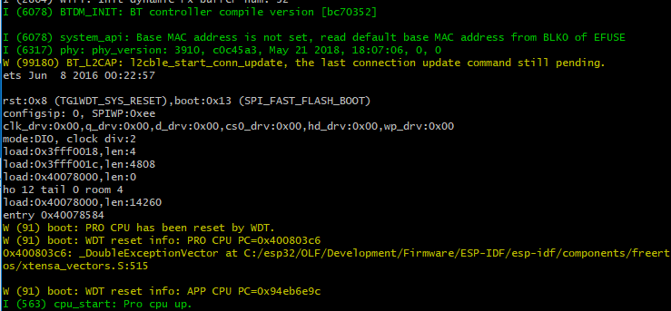

Does the 0x8 (TG1WDT_SYS_RESET) , boot: 0x13( SPI_FAST_FLASH_BOOT)
indicates a specific type of event that transpired and it caused the reboot?

Attaching the crashing log
- crash.png (30.24 KiB) Viewed 36868 times
Re: What is "ets Jun 8 2016 00:22:57"
Literally what it says somewhat below: the watchdog timer reset the CPU. Given where your program stops executing: are you sure your hardware has a good enough power supply?

When happens / Observation:
I will leave the system on overnight (with a console open showing logs from ESP32 Things Board) and will find a reset.
Tasks running:
1. A LED blink loop
2. xSemaphoreTake waiting with max delay (nothing will feed the semaphore overnight)
Also, event loop to reconnect WiFi
My understanding so far:
Reading through the other forum posts regarding this reset my understanding is that it is Interrupt watchdog (Timer Group 1)
"The interrupt watchdog makes sure the FreeRTOS task switching interrupt isn’t blocked for a long time"

I have now enabled GBD stub on the panic handler.
Now let's see what happens ....
@ESP_Sprite: Given that my understanding is the reset is by Interrupt watchdog, I am curious why you suggested looking at power.

What version of ESP-IDF are you each using? For WiFi stack, a bug causing interrupt WDT resets was recently fixed.
If you have any sample code you can please post, this may help narrow it down.

@mobhuyan: I'm saying it because from experience, a bad power supply can lead to lots of unexpected weirdnesses in the startup procedure (where sumesh's problem was) and is very easy to check (just use a different USB cable and a powered hub, or an external power supply or something). It stops people from chasing a red herring later.

I had this issue, and in my case was that I was setting GPIO 8 as a Digital Input.
