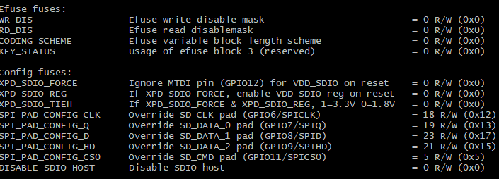

1 - Connect SDcard to standard Flash pins (GPIO 6-11) and the Flash to VSPI pins (GPIO 5, 18, 19,...). Let JTAG pins (GPIO 12-15) unconnected. Burn efuses for new Flash mapping.
2 - Connect Flash to standard Flash pins (GPIO 6-11) and SDcard to pins for JTAG (GPIO 12-15) and GPIO0,2 recommended by official documentation (SD/MMC slot 1 HS2_CMD, HS2_CLK, HS2_D0, HS2_D1, HS2_D2, HS2_D3 lines). And do some tricky stuff with GPIO0,2 to enter UART download mode. Remap JTAG pins into other pins.
Well, I'm testing the first one and I'm having some troubles:
First of all I have burned the efuses:
burned efuses.png (34.2 KiB) Viewed 5368 times

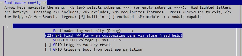

Then I have configured the WP pin to GPIO 22:
And I do it a try: DIO mode works, but in QIO mode it doesnt work at all.
