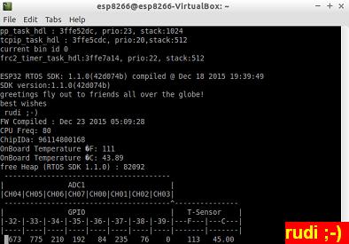

Hi
we have onSoC Sensor as temperature.
we have uint8 as F ( Fahrenheit ) ?
this are ~ -17 °C to 123 °C
so we can use simply code for conversion in Celsius, too?
// simply code
uint8 temper;
float celsius;
temper= temperature_sensor_read();
celsius = ( temper - 32 ) / 1.8;
printf("Sensor onBoard is F: %i    C: %.2f\n", temper, clesius);
can we calibrate the sensor or can we use simply calibrate
by add or subtract comparative measurement and the difference to the reference?
ps:
the sensor shows actually in a loop stable value.
the value itself must be calibrate if use for ambient temperature.
factor for self-heating to be considered by measurements?
Test TempSensor.JPG (22.24 KiB) Viewed 25059 times
[/url]
( you can click for follow to a < 1MB video of the output and enlarge the pic )
btw:
i tested utf8 code in minicom for degree char with 0x00B0 but this shows not the right
in minicom. if you have the right conversion in this, reply/add yours please.
printf(" %cF: %i\n ", 0x00B0, temper);
printf(" %cC: %.2f\n ", 0x00B0, celsius);

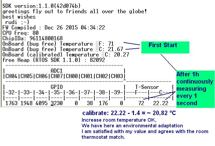

Hi
think this is the finnish version:
be sure you subtract 32 from what is read result by
for me this works with a second little calibrate then ( 1 F ) comparatively with a DS18B20. for measurements ambient temperature in which is exposed to the ESP
completely adequate, txs espressif!
simple code:
// simple code for the measurement of OnBoard sensor
// rudi 26 Dez 2015
// base is RTOS SDK 1.1.0
// ESP31B (1. Revision "false silkscreen")
uint8 temper;  // result in fahrenheit
float celsius;    // conversion in Celsius later
uint8 bugCorrection = 32 ; // bug correction value
// which can differ locally, fine tuning is always made
// by each itself, for me it was 0.6 degrees Celsius,
// that are 1,08 Fahrenheit ,  i round down to 1 here:
uint8 calibrateCorrection = 1 ; // calibrate with an mercury thermometer
// read now from SoC
// bugCorrecture - 32
temper= temper - bugCorrection;
// calibrate with an mercury thermometer - 1 Fahrenheit
temper= temper - calibrateCorrection;
// conversion fahrenheit in celsius
// output fahrenheit and celsius result
picture ( done in windows XP with simple terminal ):
shows a calibrate with 1.4 °C
ps:
if you use this for ambient room measure fast and long time, there is a litle-little self-heating. test it by yourself and you can see a little little by max 0. 1 - 0.6 °C more as you calibrated .
If you use later Wifi and other we must do this again, the reference is
the first measuring with a calibrating like here.
if you use this for self-monitoring esp then you do not need calibrate again.
the value is the end value, for testing , you can use a Infrared Thermometer
