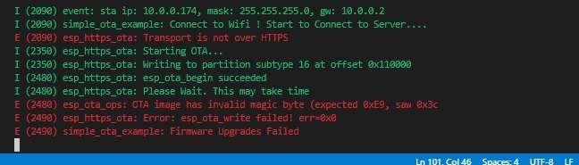

Have you found out anything about basic authorization ?! I'm trying to do the same thing as you but all I get is the error with "wrong magic number" (see img attached). Could you point me to the right direction if you have found out anything ?
Best regards, Kostas.

0x3c is the left angle bracket character, which hints that the server might be returning an HTML page.

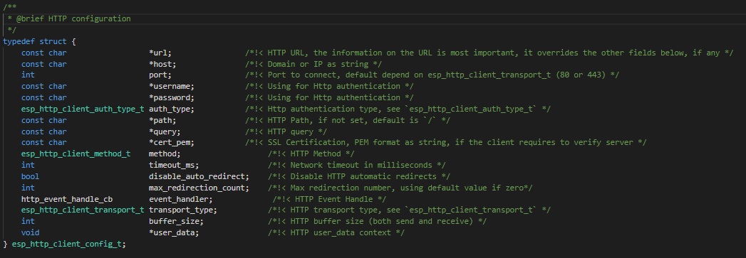

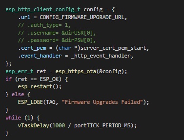

I'm developing FW for a customer of mine and I'm looking for a way to secure my OTA from attackers, copiers etc. I've read already Flash encryption and Secure Boot but these things secure other stuff. Now... what happens if someone gets his hands on the url that ESP32 downloads the OTA file ?
Isn't it possible for someone to "sniff" the url and download the OTA file in his PC??
Which is the right way to secure OTA file ?
P.S. I've noticed that in the struct esp_http_client_config exists an auth_type, username and password parameter. (attached image STRUCT_esp_http_client_config)
So i guessed that if i fill these parameters and add a usrname/password in the OTA url directory there I'll have a password protected https FW download. (attached image CODE_simple_ota_example)

You can have 2 step protection. One is to have secured flash and bootloader with eFuse etc. So, even if someone will download your file or make copy from your esp32 product (dump binary) it will be not possible to see how code looks like. Second step can be with key (any value) stored in nvs in production, now your app can test if this key exists and if its correct. In such case you can let them download your OTA bin because its useless to them.

Check this PR github.com/espressif/esp-idf/pull/2688
Authorization by client certificate looks more secure.
