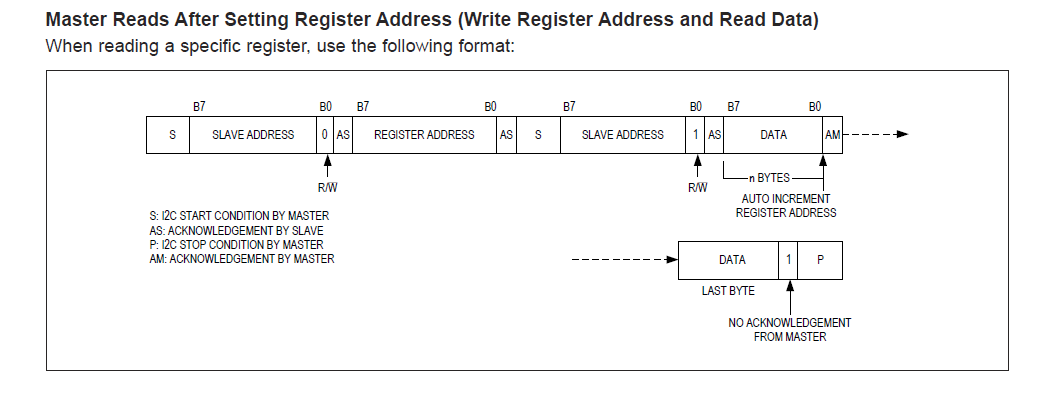

BTW: this is what my final operation will look like (when I get it working):

Well, my HW guys have checked out the board and say it looks OK, so I'm inclined to think I'm doing something wrong.
Here's a code snippet of my attempt to implement the protocol described in the drawing in my above post.
    m_i2c_cmd = i2c_cmd_link_create();
    ESP_ERROR_CHECK(i2c_master_start(m_i2c_cmd));
    ESP_ERROR_CHECK(i2c_master_write_byte(m_i2c_cmd, (uint8_t) ((devAddr) | I2C_MASTER_READ), true));
    ESP_ERROR_CHECK(i2c_master_write_byte(m_i2c_cmd, (uint8_t) regAddr, true));
    ESP_ERROR_CHECK(i2c_master_read(m_i2c_cmd, data, 2, I2C_MASTER_LAST_NACK))
    ESP_ERROR_CHECK(i2c_master_stop(m_i2c_cmd));
    err = (i2c_master_cmd_begin(I2C_PORT_NBR, m_i2c_cmd, 100));
Does anything jump out at you as wrong here?
Thanks.
