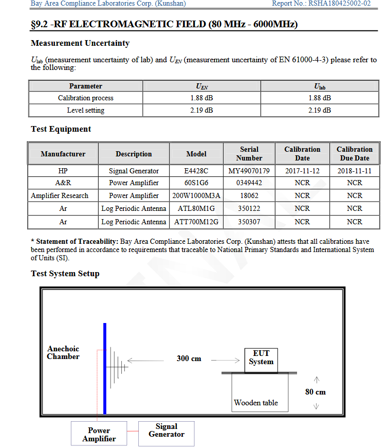

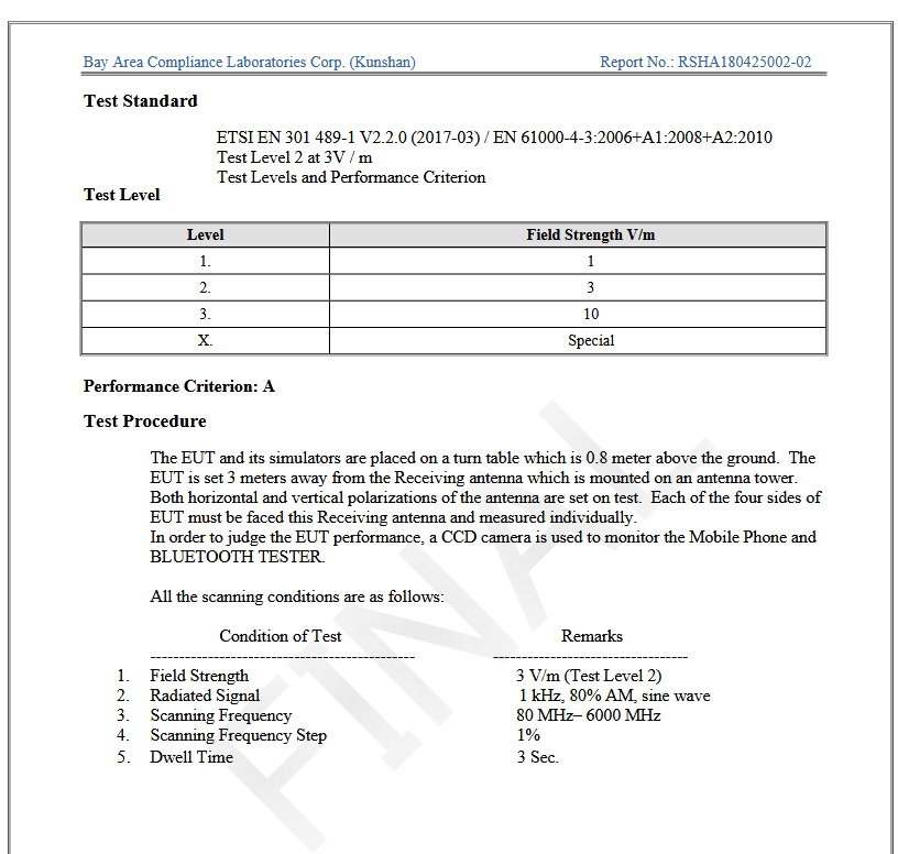

Enclosed please find the measurement report of WROVER-B in this test. When we are going under certification, we used test level 2 (3V/m), however you used test level 3 (10V/m), and currently we don't have test data for level 3, and in the specification it doesn't specify which level is mandatory for the testing, could you help switch to test level 2 and do some testing, and get feedbacks to us?
Thanks.
Alvin

The reason we use the 10V/m is because our product will be used in a marine environment where the level is is determined by EN 60945. This is level 3 which is 10V/m. I think it is the same for industrial environments.
We did test at 3V/m above 3GHz and also had a failure at 3.2GHz.
Can you confirm that you have done the EN 301 489-1 immunity tests {9.2 Radio Frequency Electromagnetic Field (80 MHz to 6000 MHz} on the WROVER-B with PCB antenna? or on the WROVER-IB with external antenna?
