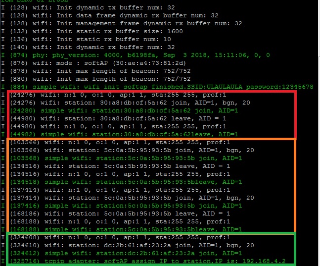

Re: v3.0 to v3.1 migration guide? WiFi not working...
According to my observations in the new versions of IDF (it seems after 3.0.x) all password login modes on the WIFI_AUTH_WPA_WPA2_PSK access point do not work
however, logging in without a WIFI_AUTH_OPEN without password works fine.
I do my code in the process of creating use WIFI_AUTH_OPEN
I also noticed that apple devices (IOS) successfully connect via WIFI_AUTH_WPA_WPA2_PSK, while android does not work
I (27201) wifi: n:11 2, o:11 2, ap:11 2, sta:11 2, prof:11
I (27203) wifi: station: 30:a8:db:cf:5a:62 join, AID=1, bgn, 20
I (63361) wifi: station: 30:a8:db:cf:5a:62 leave, AID = 1
I (63363) wifi: n:11 2, o:11 2, ap:11 2, sta:11 2, prof:11
I (67905) wifi: n:11 2, o:11 2, ap:11 2, sta:11 2, prof:11
I (67907) wifi: station: 30:a8:db:cf:5a:62 join, AID=1, bgn, 20
I (104057) wifi: station: 30:a8:db:cf:5a:62 leave, AID = 1
I (104059) wifi: n:11 2, o:11 2, ap:11 2, sta:11 2, prof:11
I (108659) wifi: n:11 2, o:11 2, ap:11 2, sta:11 2, prof:11
I (108661) wifi: station: 30:a8:db:cf:5a:62 join, AID=1, bgn, 20
I (144807) wifi: station: 30:a8:db:cf:5a:62 leave, AID = 1
I (144807) wifi: n:11 2, o:11 2, ap:11 2, sta:11 2, prof:11
I (149367) wifi: n:11 2, o:11 2, ap:11 2, sta:11 2, prof:11
I (149369) wifi: station: 30:a8:db:cf:5a:62 join, AID=1, bgn, 20

Now I tried to run an example from the IDF 3.1.2 a simple Wi-Fi.
It doesn't work)))
It doesn't work)))
Run an example (in its pure form, without changes) from the IDF 3.1.2 a simple Wi-Fi
1. Sony device. With android 6.0.1
Connection hangs on .... Getting the IP address
2. Samsung device. With android 4.3
3. Apple device. With IOS 4
Connection FINE
Connection FINE
Someone working with the Wi-Fi WIFI_AUTH_WPA_WPA2_PSK authentication (password is not empty)
Is there a problem with me or someone else?
I did not expect from ESP problems with WiFi.
If i use .max_connection = 1 the connection hangs on getting the IP address when using WIFI_AUTH_WPA_WPA2_PSK. IOS devices connect perfectly. The problem is only when connecting with android I have tested three devices. If you use WIFI_AUTH_OPEN any devices connect successfully.
If i use .max_connection = 4 (for example) with WIFI_AUTH_WPA_WPA2_PSK. All devices are connected and get ip. But be sure to have a network device with IOS.
What could be the problem?

Sorry for the issue introduced in IDFv3.1.2. We have found the root cause. And it will be fixed in release/v3.1 branch today. The commit ID will be be115ec3ab28f7bbea3f4c7e5be3dd6b17bb8912. Please update IDF after the bugfix is merged into release/v3.1 and check whether it solves your problem.
