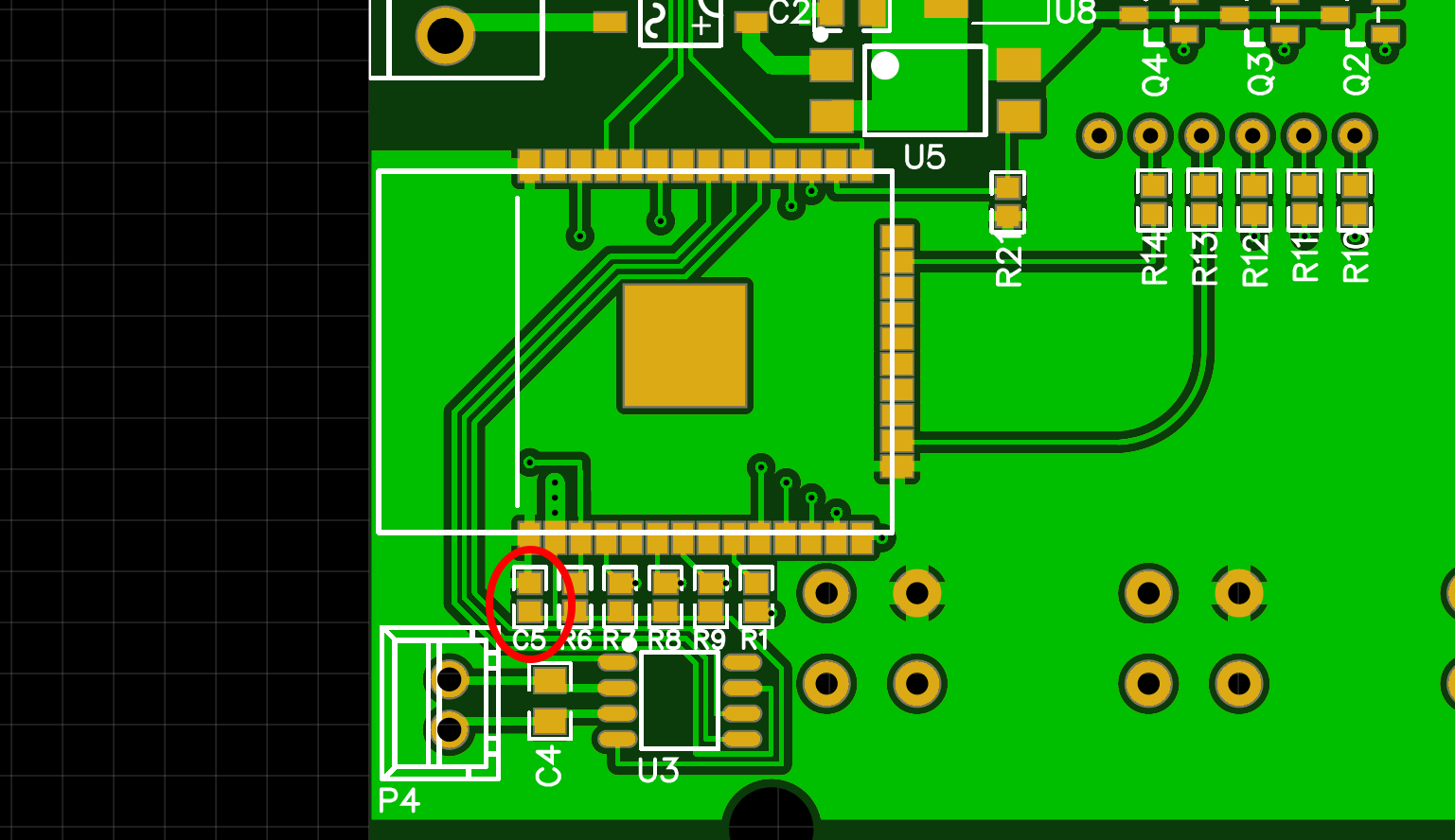

I suggest you add one 1uF cap close to ENABLE. Like below showed:

C5 of 1uF is placed very close to ENABLE. However, I do not have that R2 resistor. I guess its purpose is to isolate the analog ground from the digital ground.

You actually do have the equivalent of R2 in the schematic; it's R6 on your PCB. What you do not have is an 1uF cap from EN to GND. C5 on your PCB is a decoupling cap, the same as C2 in Stone's schematic.

Thanks @ESP_Stone and @ESP_Sprite, it seems I was very tired when reading this. Indeed, this capacitor is part of Figure 4: ESP32-WROOM-32 Peripheral Schematics from ESP32-WROOM-32 datasheet and I somehow missed it.
I will solder an extra capacitor and report back. Let's see if @nebkat issue is related to mine.
